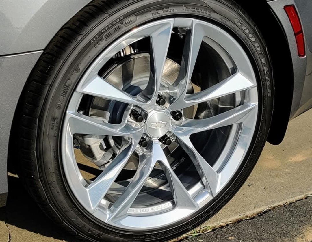

Having tried both styles on the factory-option polished-finish forged wheels, I did not like how deep the standard lugs went into the cones on the wheel versus how the bulge-style lugs held the wheel. However, the locking lugs I am using (factory/McGard) use the standard cone - but that has worked out ok with just one per wheel and going on last.

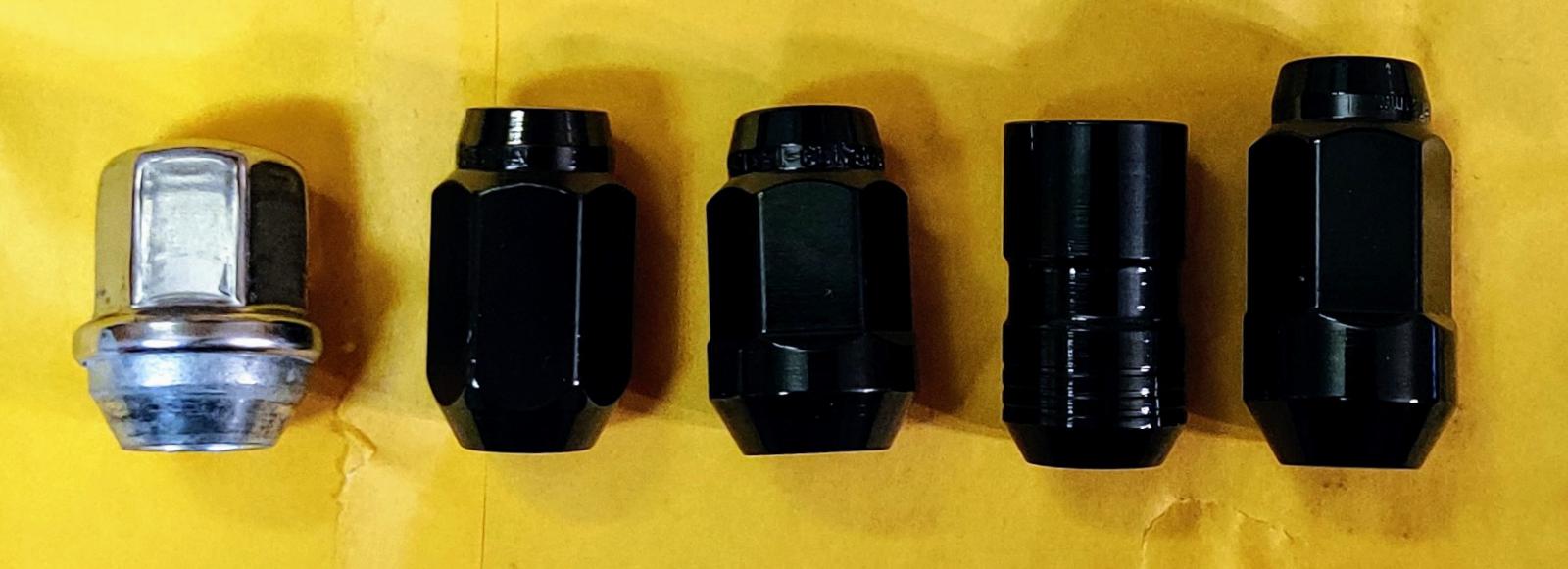

I posted a photo of four options for black lug nuts in the following thread. Five years down the road, I am 100% satisfied with the McGard option I went with (#64034). The "savings" from the Gorilla set (71643NBC) I had on my 2016 1LT was not worth it... they were rust stained in almost no time.

The long and short McGard bulge-seat lug nuts both fit fine, although on Amazon it says the shorter one is correct for Camaro and the longer one is not. The specs from McGard looked the same (other than the overall length), and I emailed McGard tech service before I ordered and they confirmed they would fit factory wheels. The longer lug nut seemed to make it easier to guide the socket onto the lug nut without dinging the wheel. To my eye, there was little cosmetic difference, so I opted for the potential practical benefit of the longer one!
I ordered them from Amazon, but they only came in four packs - there was no combo kit, unfortunately. And they are a little pricier now then when I got them in 2020/2021 at just 29 bucks a pack. https://a.co/d/0f3ETSru
