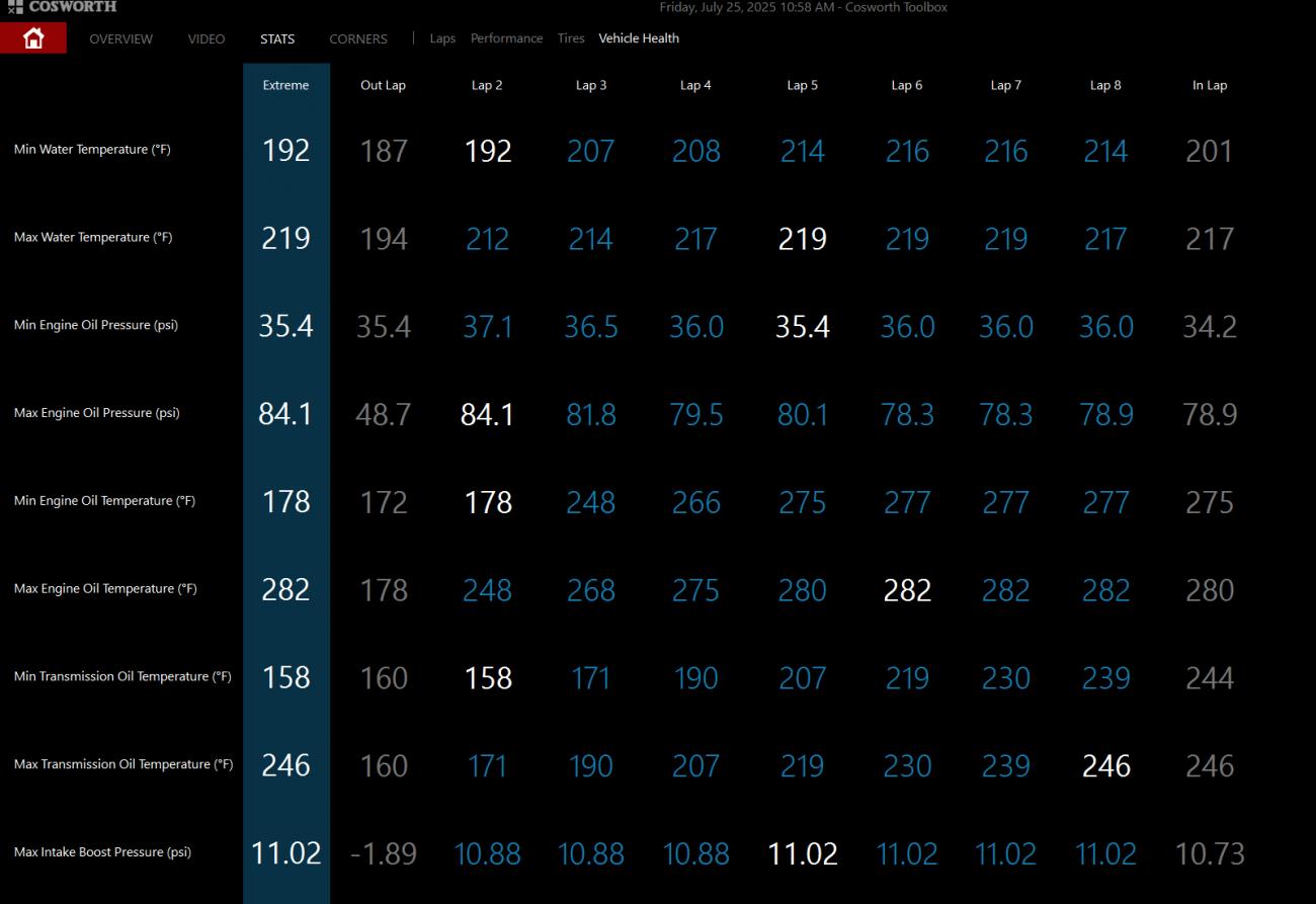

Sorry I missed the notification. I run 15+ track days a year. I have run the camaro for two years and have just over 4K track miles. I run the 15-50 and follow the maintenance schedule. every 500 track miles - dump oil, every 15 track hours dump trans and diff fluid etc.
This screen shot was from a 90+ degree day at VIR on July 25th at 11 am. I found the watkins glen 100+ degree day (see video below) but I didn't program the pdr so cosworth thinks there was only one lap but you can check out the youtube as i run an aim system as well and it should show the oil temp. also know that was second time at watkins and first with the camaro. you can check out some of my other videos but i usually only post new tracks that I go to.
