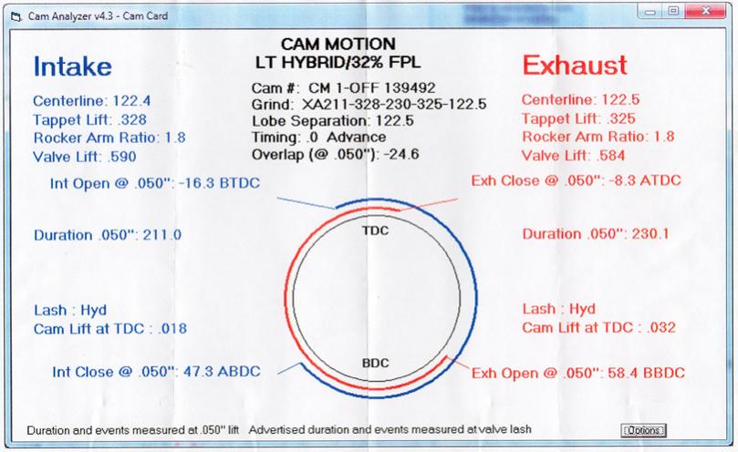

Originally Posted by 18.2SS.1LE View Post
Call Cam Motion, they can grind you a camshaft to whatever specs you'd like.
I did that last year. What do you think of this cam profile? Looks familiar?
ZL14ever is offline   Reply With Quote
Some LS9 action in your LT4?!
Yes. It drives 100% stock & gained 3-4 mph in the 1/4
