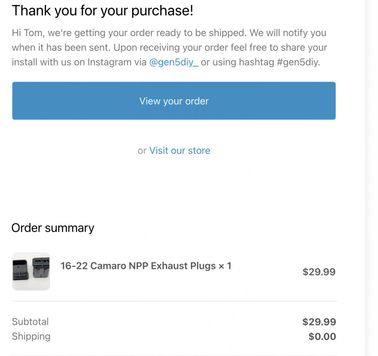

I used these plugs from Gen5dyi, then neatly tied up to harnesses.
