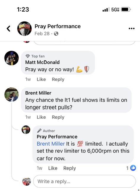

He did say on FB he has the limiter set below 6k to keep the car from blowing up until he can get upgraded fuel system. Just sharing what I saw.
I too was like dam that’s impressive but not sure how it’s possible lol

This here…

That makes more sense. I knew there was no way it had enough injector to make a full pull.
Totally
If that was a PD blower making 20% more midrange torque that setup would be out of fuel at 3000 RPMs…
Oh yeah for sure. I am honestly surprised it can even make a pull to 6k rpm but Brett probably has a few tricks under his sleeve with injector timing and rail pressure to squeak a little more out.
The most I had ever seen a stock LT1 fuel system support on 93 was 650whp with a cam. That was the general consensus when discussed in past around here. Which is why upgrading the fuel system has been recommended for years now.
We know the stock LT1 fuel system is good to 550whp on an honest dyno. Add a bigger fuel lobe cam will net another 100whp of fuel headroom on the high side. The cam is going to make the extra 100whp without increasing boost, so you are always up against the LT1 fuel systems limits...hence why nobody runs it on a DI only setup with boost.
So, I will assume there must be a shortage on fuel system components, because I don't really see Brett recommending this setup. Had to be a "make do" situation until fuel system parts show up.
