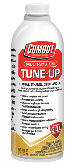

Originally Posted by ZO6Ted View Post
Could Seafoam be good once in a while anyway since we are DI? If so for carbon buildup I'm doing it.
far superior to Seafoam..
