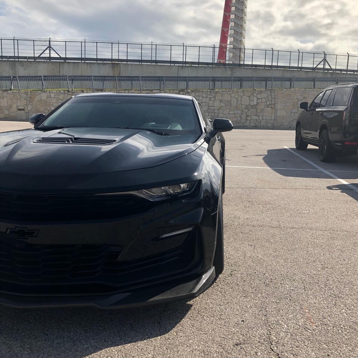

Next weekend we will be taking my car down to COTA for the CHIN TRACK DAYS EVENT. I am really looking forward to it because it will be my first time on that track and also I will be taking my son as a secondary driver.
Now normally I would simply drive to the event, make some front camber changes and the do the event and drive back. In this case though if you have been following my other thread you will see that we have been playing with a track only tire and wheel setup that we will use on the car.
We are going to run some pirelli slicks 305 660 18 SQUARE on EC7 18 x 11 ET25 APEX wheels. Front camber will be -3.6 degrees with back camber at -2.5 degrees. The OVERALL diameter of this tire/wheel combo is around 26 inches so about .4 an inch SHORTER than my SQUARE DAILY DRIVING setup with SM-10 ET22 19 x 10.5 APEX wheels wrappped with 305 30 19 MS 4s tires. We will take the MS setup in the unlikely case it rains. I have run the MS setup in the rain at Eagles Canyon Raceway and they worked well enough for some 2.12 laps which is plenty quick in the rain.
A word about the track setup. The slicks run WIDER than a normal passenger tire so we found on a NON-ZL1 fender, that this is the WIDEST square setup you can run WITHOUT tire poke and WITHOUT using front spacers. Because of the reduced diameter, there is NOT the issue with the tire rubbing through the front of the inner fender well on the drivers REAR side.
The second thing is I TRIED running a 315 30 18 TOYO RR tire but simply put, that tire runs wider than others and we were getting tire rub against the strut BODY. As mentioned by others and confirmed with our own testing the pirelli slicks are slightly narrower than other brands so that works fine here.
As far as brakes go I have ZL1 brakes on my SS 1LE and we will be using
DTC-70 pads on the front and DTC-60 pads on the rear. I made the mistake of trying STREET 5.0 Pads and that pretty much was a disaster in the area of FADE and WEAR especially compared to the OEM setup which was far superior.
We will be running with the BLUE group on SUNDAY only. They will have 4 - 30 minute track sessions and a happy hour ONE hour track session at the end of the day. Last time I checked they still had some NON-NOVICE slots available for the TWO day saturday sunday event and just ONE slot (SOLO only) for the Sunday event. You have to be signed up as a CHIN TRACK DAYS member which is a 50.00 deal and takes about ten minutes on line.
https://chintrackdays.com/how-to-join.aspx
I am kind of using this as a discovery trip as well to see where we might want to sit for the upcoming F1 race that is being held here in October.
You guys are welcome to come join us. We will be in the BLACK 2019 Camaro you see in the avatar.

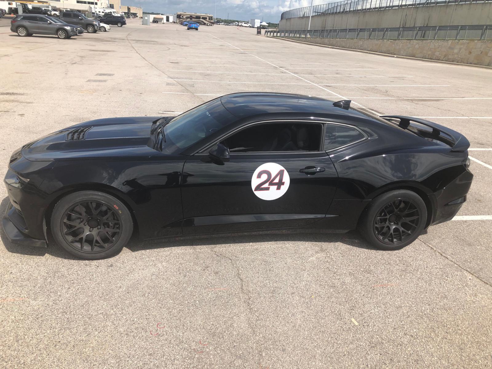

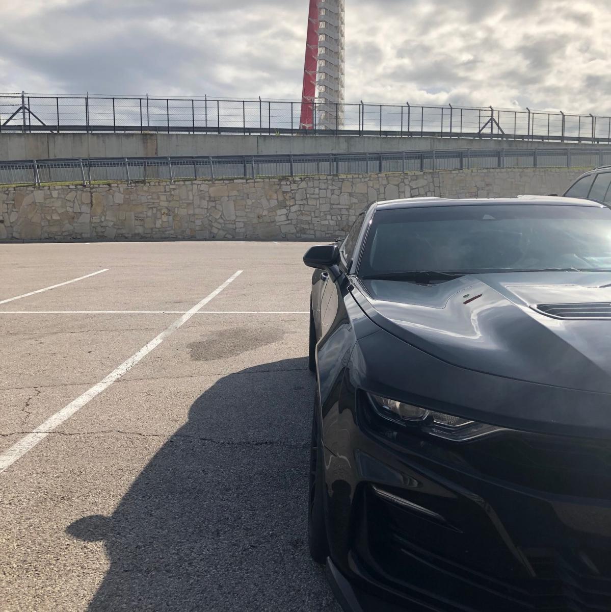

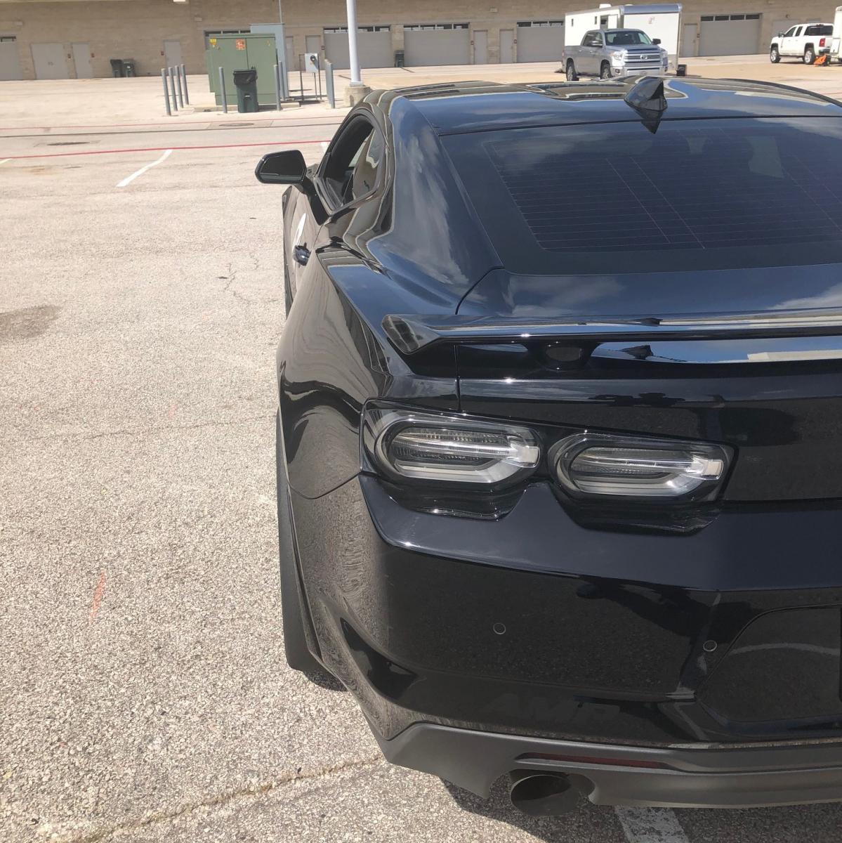

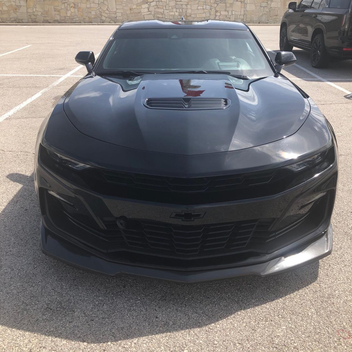

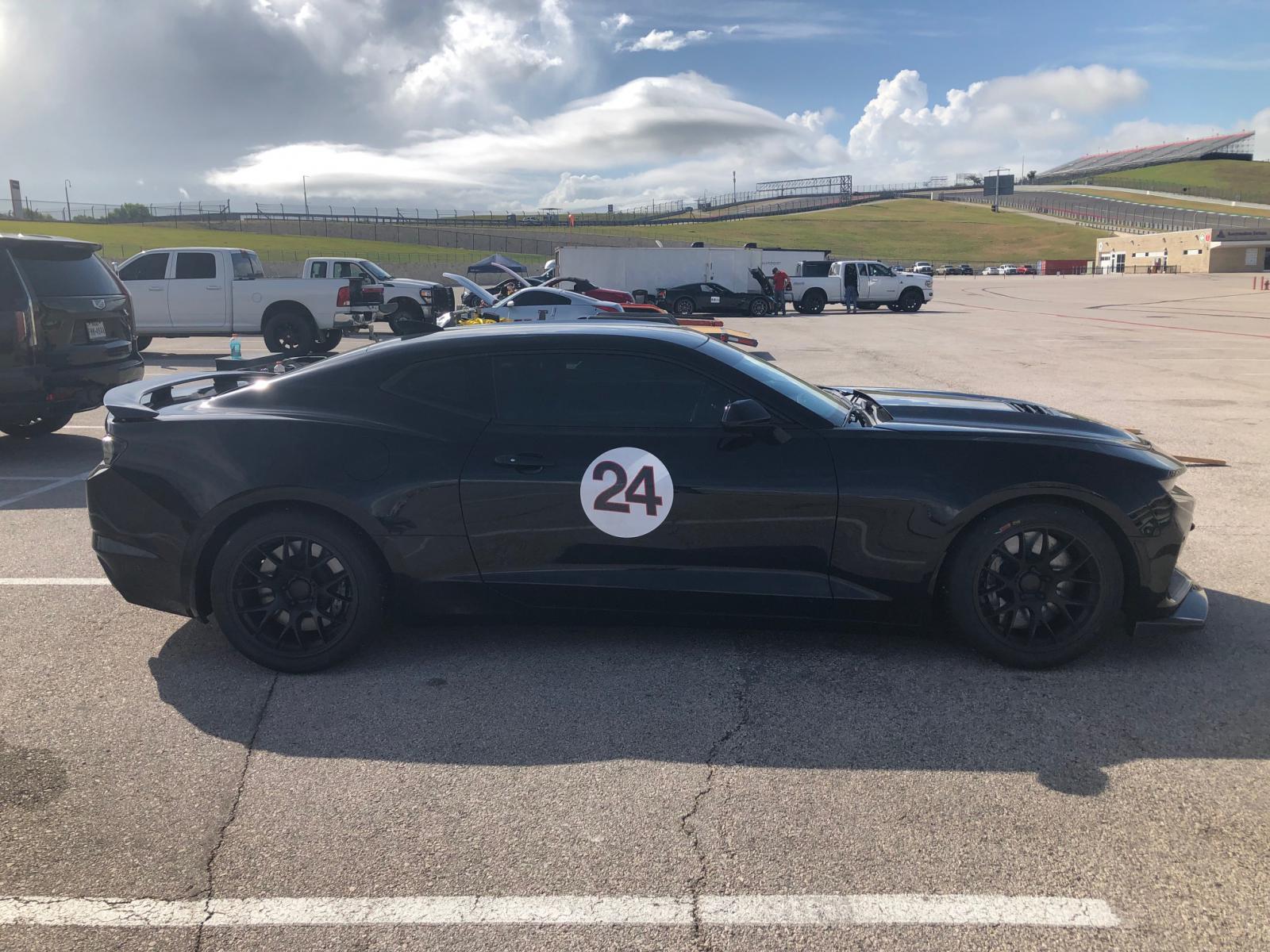

UPDATE from Track COTA
Ok guys,

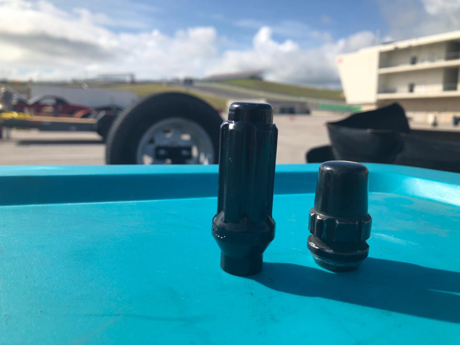

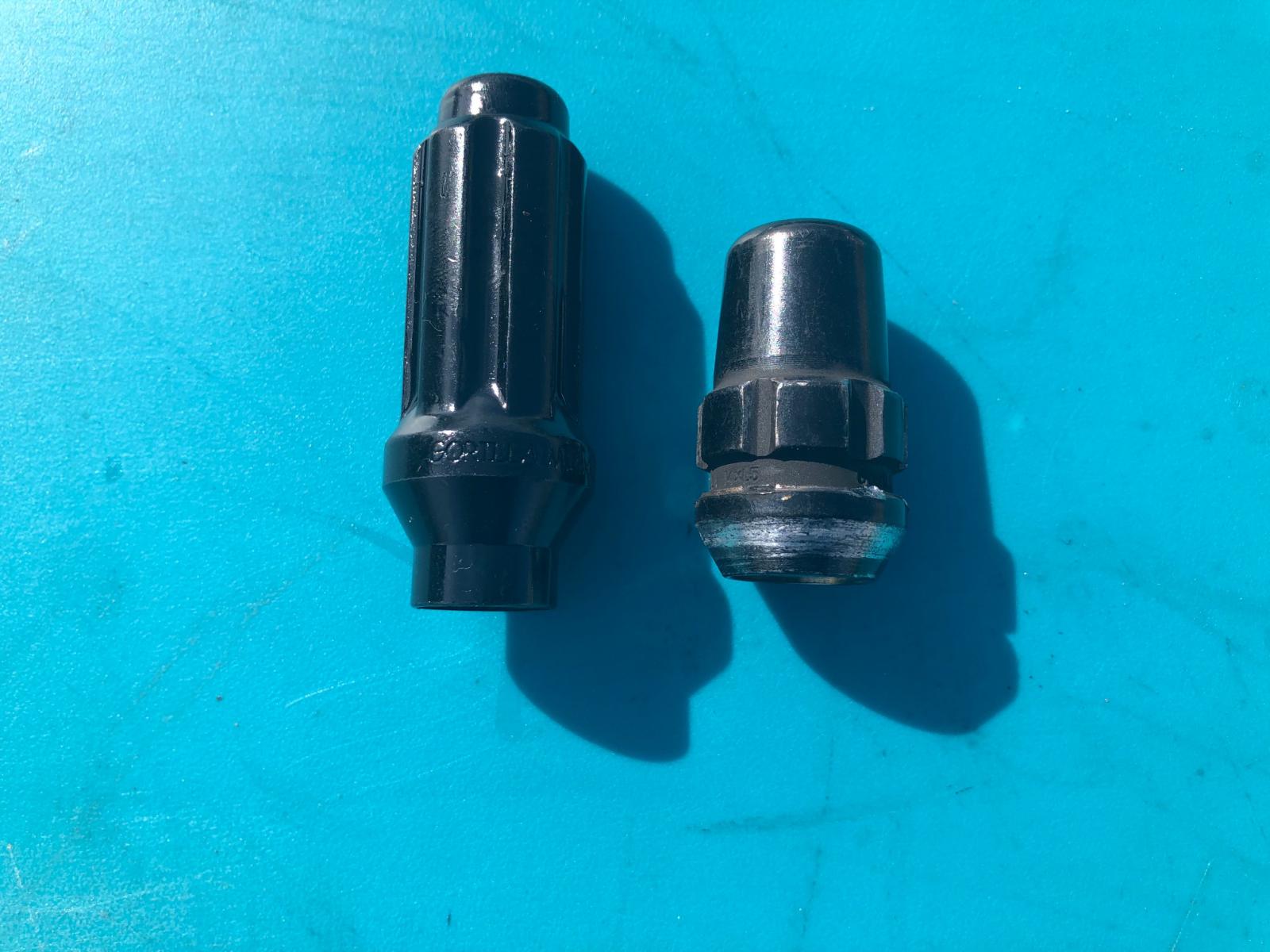

After we worked with it for a while we decided to run 5MM spacer on the FRONT with the EC7 18 x 11 ET25 with Pirelli Slicks 305 660 18. WE DID manage to get enough clearance WITHOUT a spacer BUT it was only about the width of a folded piece of paper which in out opinion was just too close so thats the deal with using the 5MM spacer.
Now normally you would run extended studs to compensate for the spacer. But we we used a different lugnut that has a small sleeve that actual engages the stud from INSIDE the lugnut hole. Using the standard lugnuts (GORIILA) we could only engage the stud enough for 5 complete turns. As some of you are aware, from a safety standpoint, you want at LEAST SEVEN complete turns. With the EXTENDED lugnut which by the way would also work with extended length studs, we got about 10 turns. Problem solved. Below I have included some pics of the lug we were using compared to the new ones we are using.
Even with the 5MM spacer, the wheels and tires fit great we no issues, See pics below. The DTC 70 and DTC 60 pads did their job and never faded although the did get hot as f*ck. The sessions were 30 minutes long and we were hitting around 155MPH on the back straight.

155 is fast on the back straight. Stock SS 1LEs only hit about 142. I would have thought your ZL1 brakes would have more thermal handling capabilities but I know the 70s get very hot.. I was expecting to see some poke with the 18 x 11 ET25 but it looks good. Would like to see some video and lap times.
P.S. If you want your pictures to show up correctly, only use horizontal (landscape) pics and not portrait. The forum automatically rotates pics to landscape mode.

Good tip on the formatting but I fixed the images by resaving them is a SQUARE format and when you upload those it leaves the orientation alone.
In the Blue group we were running there wasnt really anything keeping up with us in the corners except for a couple of RTR cars which are basically are go karts. There certainly were a few cars with more power as we currently are basically stock with roughly 400-425 RWHP. We were braking VERY late on the back straight and the only reason I think we were seeing 150+ is because we were carrying alot of speed through the corners. We gave a few point byes to some of the faster straightaway cars only to bunch up with them again in the curvey sections ( I call this the MIATA factor,,lol).
We will be modifying this car further as we are pretty happy with the handling. Anticpated upgrades should push the RWHP into the 550-580 range keeping the car naturally aspirated at about 3650 pounds without driver.
I THOUGHT the Chin guys were tracking lap times but apparently not.

Nice write-up and the car looks great on that set up. Hope to catch you at another COTA even soon. I had the grey ZLE out there
