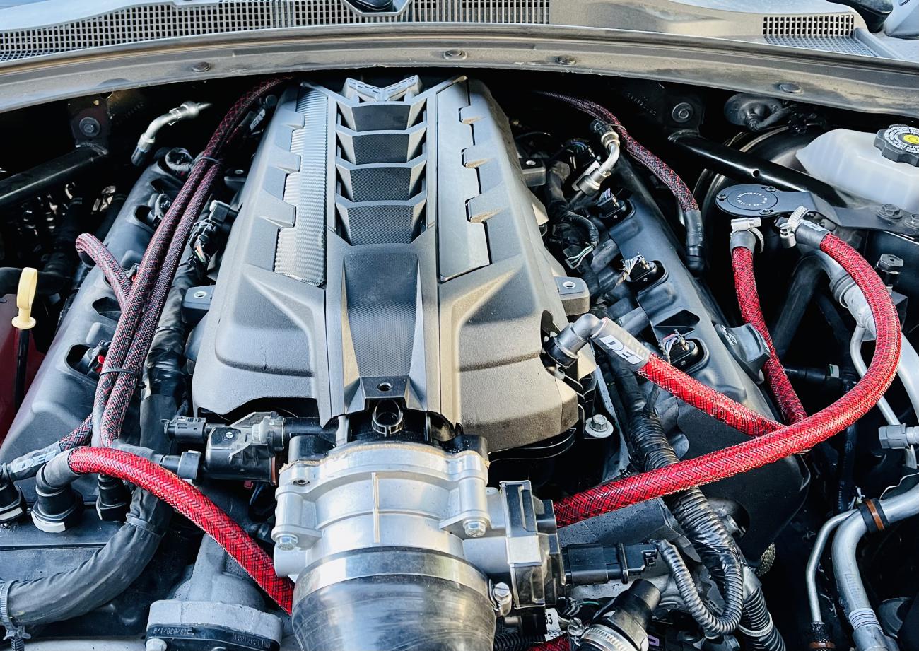

Well guys I did it. Did my research figured out it would cause no issues. And damn does it look good.

Nice job. Glad you got it the way you wanted

Looks great! Where did you get your parts from if you don't mind me asking?
