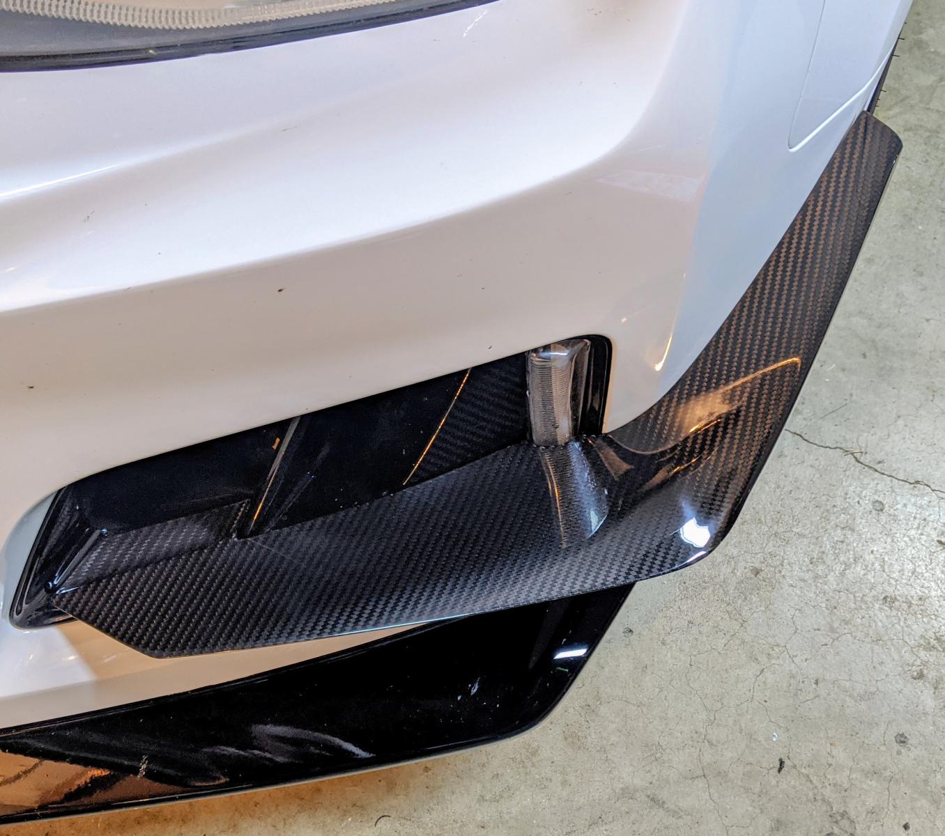

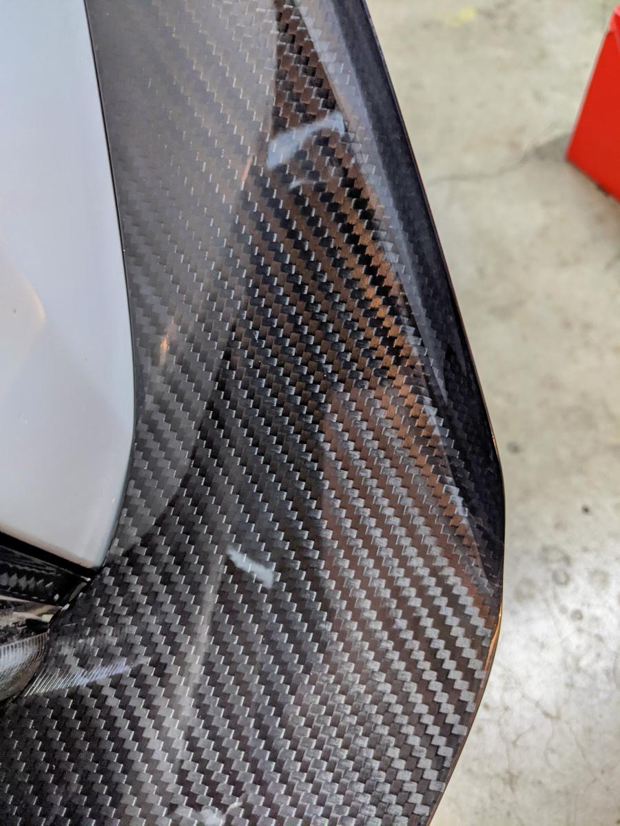

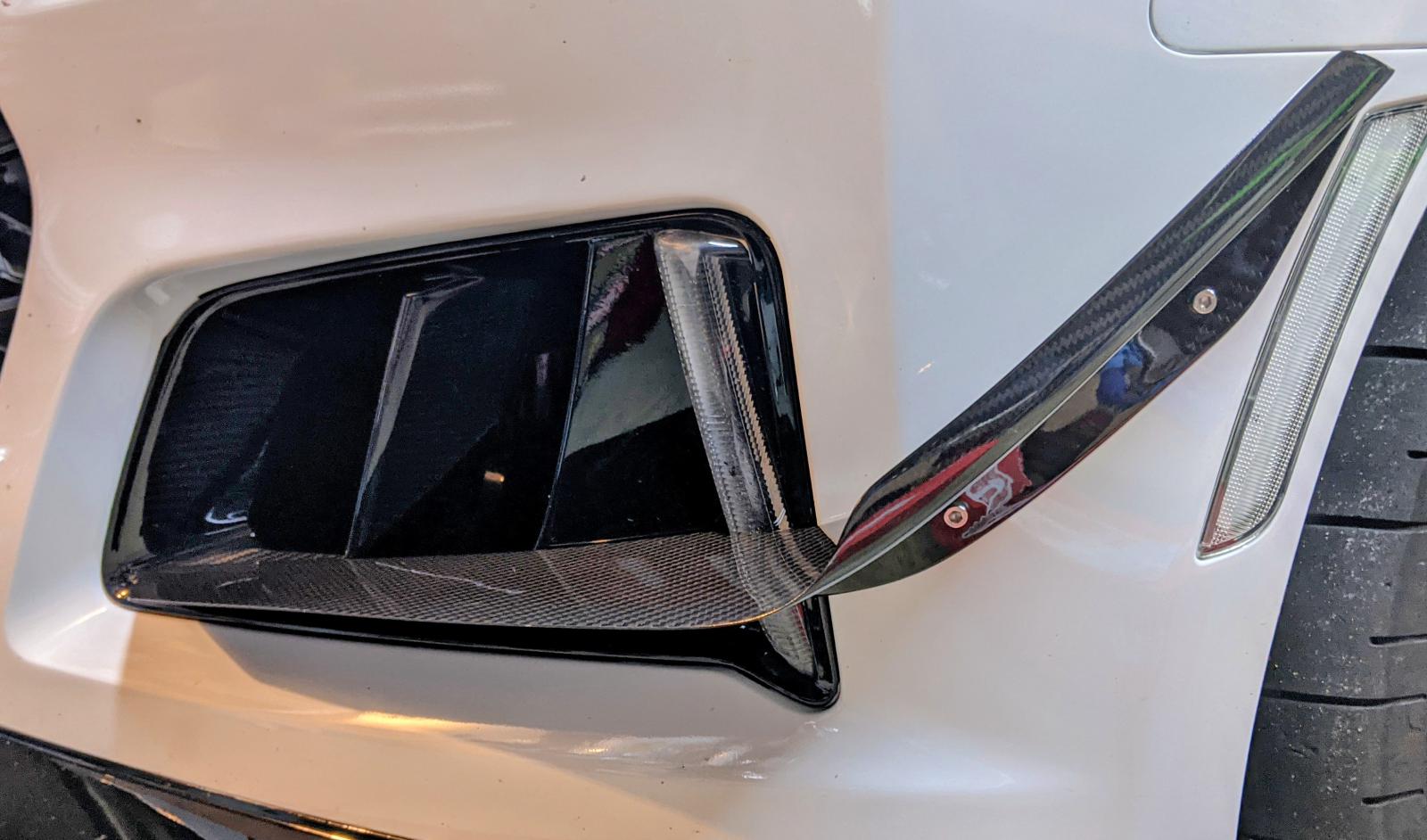

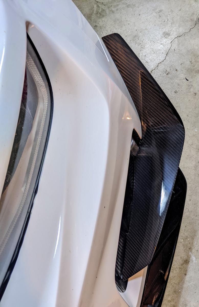

I took a few pics in my garage just now. I haven't had a chance to take some good pics outside in the sunlight. Also its hard to tell since the canard itself is so thin and the weave is super straight but they do have 90 degree bend at the ends as well.

thanks for the pics.
how does it attach to the bezel. Does it just hook in to the rear of the bezel like the ACS ones do for the SS?
Looks like a viable option. I just wish it would attach to the bumper with the hidden tab and clip like the GM ones do instead of exposed bolt heads.

That's exactly why i showed the fasteners and talked about 90 degree bend, when i ordered them none of the pics showed any of this.
The leading edge that sits inside of the vent has 3m vhb tape, then there are 3 m5 allen head bolts with nylock nuts. Two of the bolts go through the bumper and one through the vent. I agree hidden fasteners would have been nice, but to be honest they are hard to see unless u looking for them.

very true, could probably paint the screw heads black to blend in. Did you put any 3m tape between the bumper and the mounting face of the canard?

No, the fit is pretty exact and tight. I did think about putting some at first tho or even some thin felt weather stripping. However i think in the near future i am just going to put some clear silicone rtv underneath to keep water/dirt from making it's way in between.

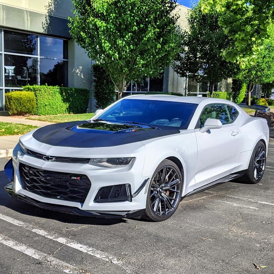

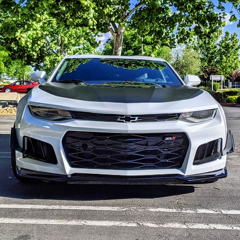

Sorry this is late but here are a couple pics further away.

Damn that looks awesome.
