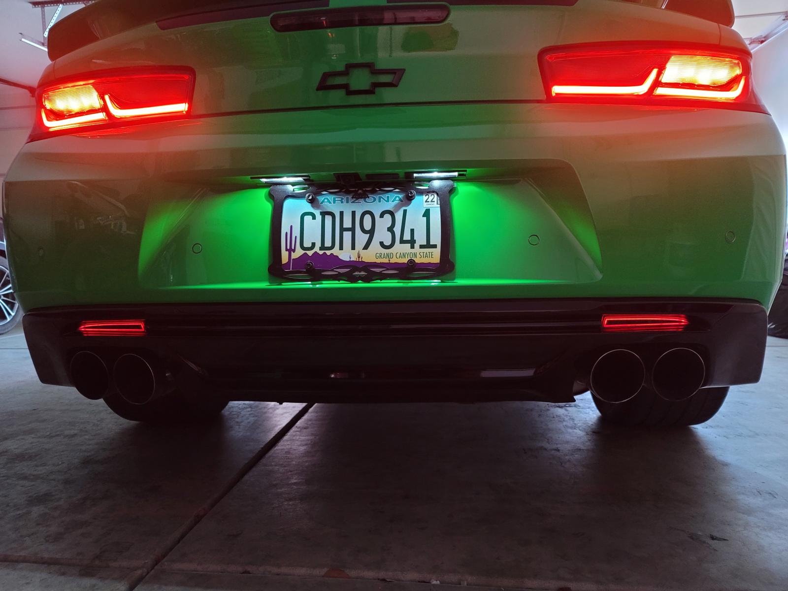

Old 01-30-2021, 05:07 PM   #6
Booher
Booher's Avatar
Drives: 2019 zl1 6 speed
Location: Lake Havasu Arizona
Posts: 1,135
Here are a couple pics with the running lights and then the brakes.

Ah, I see, thanks Booher. Your car looks awesome, those exhaust tips are massive
These dual/surround style LED strips look a bit strange to me, I think I'd prefer a single, beefier strip across the middle of the reflector, that'd feel like a better fit with the running lights.
