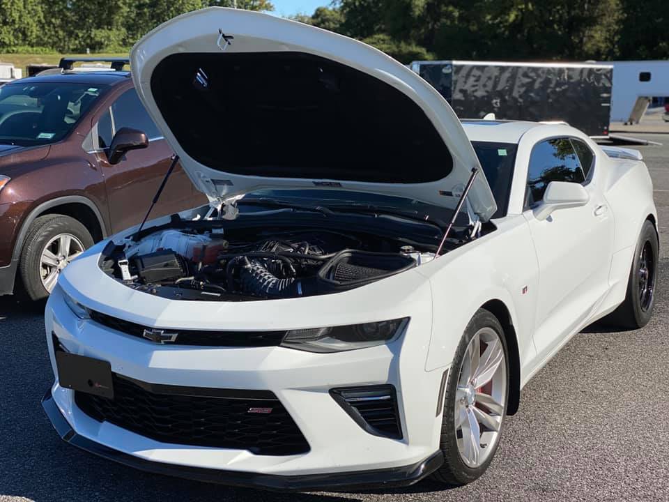

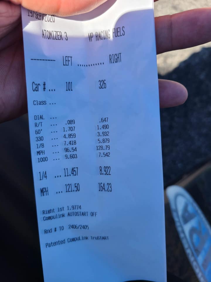

Talking LT2 Intake (Non Ported), E85, Rotofab, and ECM Tune ONLY
Installed and took my buddy's full weight 6th Gen to the track a few weeks ago.
Current Mods are: LT2 (Non Ported) Intake Manifold, Cat Delete Pipes, Rotofab, E85, and ECM Tune ONLY.
He went 11.45 @ 121.50MPH. His previous best in pretty similar conditions was 11.98 without the LT2 IM and Cat Delete Pipes.
I did not have to adjust the tune at all when I added the LT2 IM from the stock IM. It stayed 12.8ish AF.
Pretty impressed with this IM vs. the more expensive alternative. Good bang for the buck.

So what was the mph and 60' on your buddy's car before the LT2? That's what we really should be asking. Also the DA
Iassume the car is auto?

10 speed auto car? you must have went thru the traps in fifth gear at that trap speed yes? the car must have just shifted from 4th to fifth just before you crossed the line I would imagine . How tall are your rear tires?
