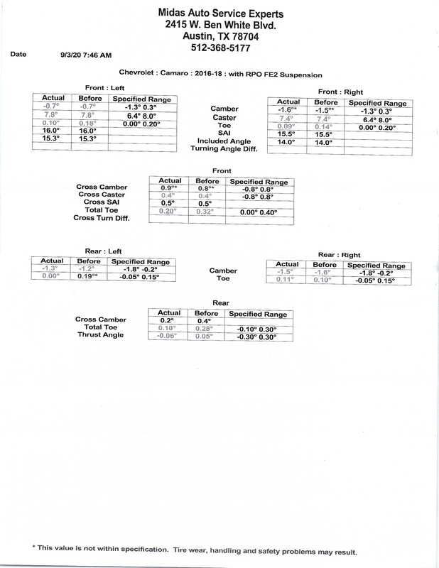

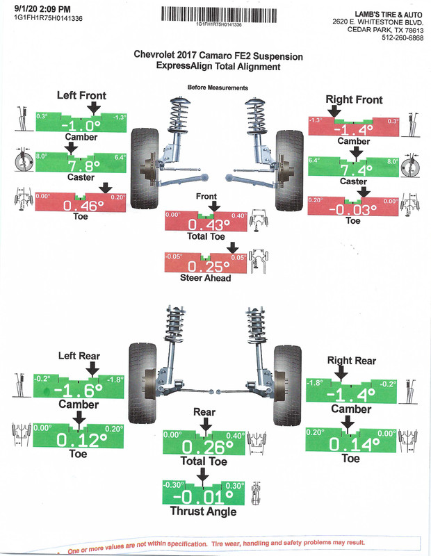

I just put my third set of tires on my 2017 2SS. My second set had some pretty bad uneven wear on the insides due to bad alignment issues. When I had my new tires installed, they performed an alignment check for me (photo at bottom) showing me it was off. I have a life time alignment at Don Hewlett Chevrolet so I told them I would have it aligned elsewhere. Well, I came to find my lifetime alignment could only be redeemed once a year or every 15k miles and since it hasn't been quite that long (I'm 1k miles off, FML) I would be responsible for paying for another alignment. I went to another shop rather than the stealership.
At the new shop, they do the alignment and tell me my front brakes are at 5% and rear brakes are at 15%. My brakes are certainly not brand new but I havent triggered any warning bars and I don't have issues stopping. They also tell me my driveside wheel bearing is bad. Now, I've had a bad wheel bearing in a different vehicle before and it sounded pretty down right awful, as in... unmistakable. I haven't really heard anything that sounded abnormal in my car other than rotating mass and tires while moving. I guess it does make a 'whooshwhoosh' sound while coasting, esp at low speeds but I've always chalked that up to tire noise. They wanted $800 for a wheel bearing...honestly I can install a wheel bearing assembly myself..and they only cost $80 on rockauto... however my extended warranty technically 'would' cover the install (I checked with them and they said it would be covered)... I can't tell if they're trying to upsell me or if they are being legitimate. I feel they are attempting to upsell however. Another problem is, I am feeling they didn't do a good job on my alignment after I compared it to my previous alignment...

First of all, am I reading correctly that Lamb's sent you home with the alignment shown in the first picture, including 0.43-deg total front toe, and more than all of that was on the left side with the steering wheel straight?! If so, then they are clueless or just don't give a damn. That box is red because that's out of spec.
Second, did the Midas place send you out with 0.2-deg of front toe? If so, then they aren't much better but at least it's in spec. But really, you need as close to zero as you can get.
Also, neither shop seems to give a damn about the fact that you have significant cross camber in the front (one side is way different than the other). That should be causing a bit of a pull, plus it's just plain shoddy work. That's fully adjustable, but they either don't care or don't know how.
Lastly, how can they tell you in one breath that they just aligned your car and in the next breath tell you that a wheel bearing is bad?! If a bearing is really shot, then the car can't be accurately aligned until it's replaced.
I'd say you are wasting your money going to trained-monkey shops that have no clue what they're doing, or that assume you don't.
