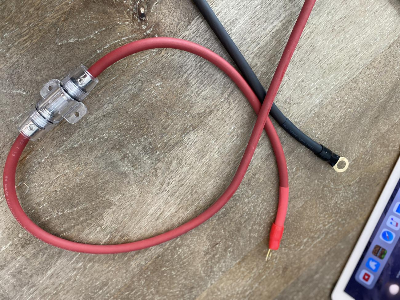

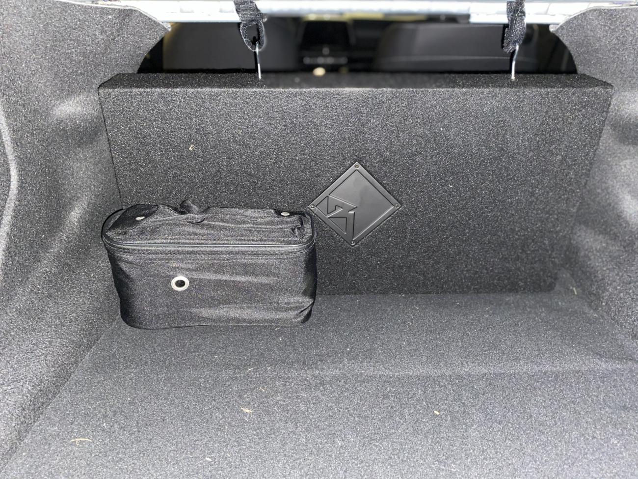

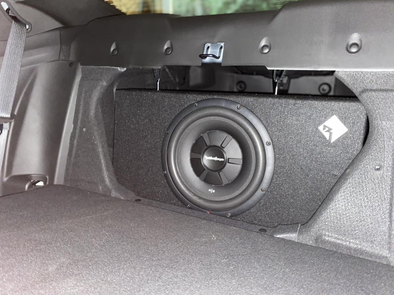

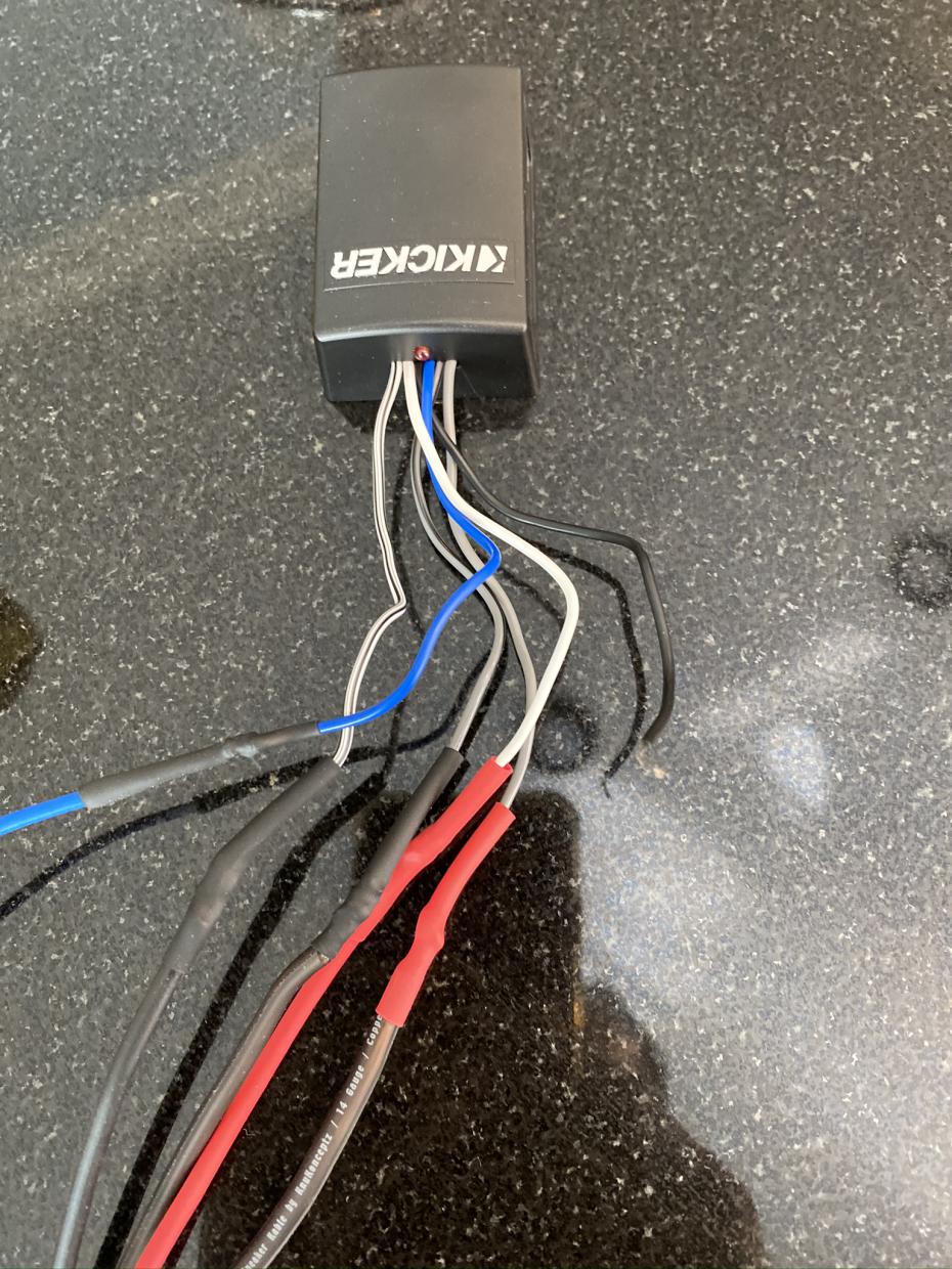

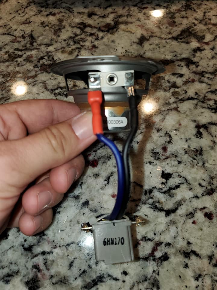

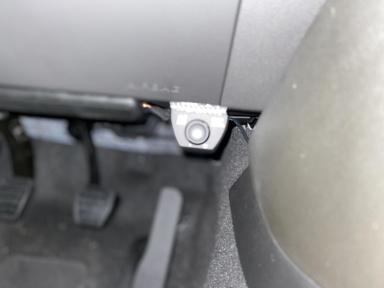

Subwoofer is in, and boy does it make a difference. Honestly it really transformed the sound. I didn’t realize how anemic the bass was.
For those of you have done this you know what a pain it is to take the trunk and side panels apart. It’s not hard, but it’s tight quarters and I went very slow and steady, not a scratch on any of the panels and no broken clips. Add to that I’m 5’11” and 188lbs and the back of the car is really tight quarters.
The biggest challenge was the amplifier I bought from Amazon was defective. I spent well over an hour backtracking and checking all the wires and connections, before figuring out it was the gain knob on the amp. It literary didn’t work.
Luckily the Best Buy 2 miles from my house had a couple good options and I grabbed a Kicker 800x1 which really works great.
Now I’m really excited for the new tweeter and door speakers.
A few things, the remote signal sensing in the Kicker LOC works great and it turns my amp on and off with no issues. For track days I installed hooks on the top of the sub and Velcro straps wrapped around the back metal deck. Speaker wires are quick disconnect so everything comes out super easy. I used Velcro to attach the tire kit to the back of the sub since I modified the styrofoam piece under trunk deck to house the amp and LOC.
I actually enjoy making the cables and soldering and using heat shrink.
I also ran the remote bass knob and it comes up by the front where I can easily adjust the bass.
Just a few pics. Will take some more of the amp area once I finish zip ties. I also ran out of Tesa tape.
