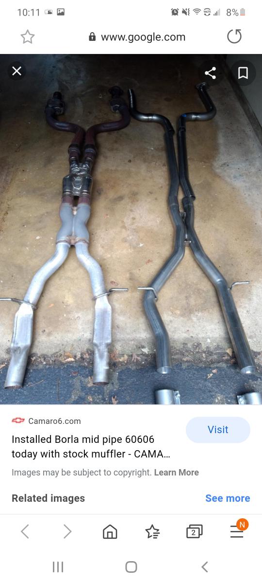

So i have a Borla 60606 kit(bought while i could find one) i have an A8 and i am not ready to program the computer to turn off the Afm function.
The question is has anyone tried using the front half of the 60606 cat delete pipes and mate it right before the x pipe.
The picture shows factory(non afm i know but still shows what i need to show) and the 60606 side by side and it looks like you could just cut a bit before the factory x pipe expand the factory pipe and slip the straight pipes right in.
I know its weird but has anyone tried this.

Look up the install for the borla 60626... sounds like that’s what ur trying to do

That could work but was looking to get closer to the x pipe.

It will turn off the function but it will throw the ses light when removimg the afm actuators out of the exhaust like i would need to do/want to do.
