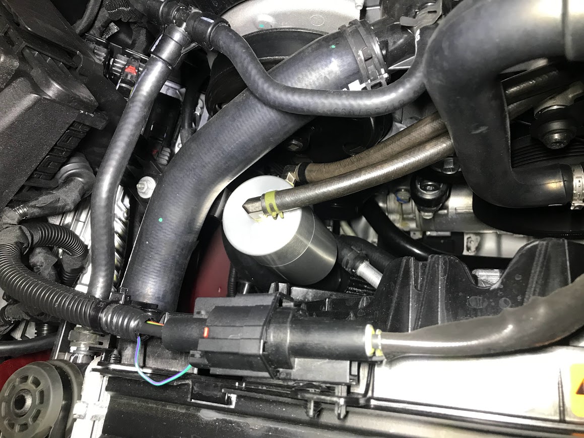

happy to see Elite Engineering here.
I bought your CC-300R-V6L can for my V6 many years ago. worked well and I kept it when the car was sold.
I mounted it to my 2021 LT1 and it worked well. I now have it on the 2023 LT1.
I want to know: Am I truly doing it right or, Is there a better one available nowadays? thanks much for a great product.
Over the years, my can made a believer out of many skeptical friends and technicians. You Got a better one that fits the LT1?
You might want to reach out to them directly for a quicker response, their last post is from 5 months ago.
