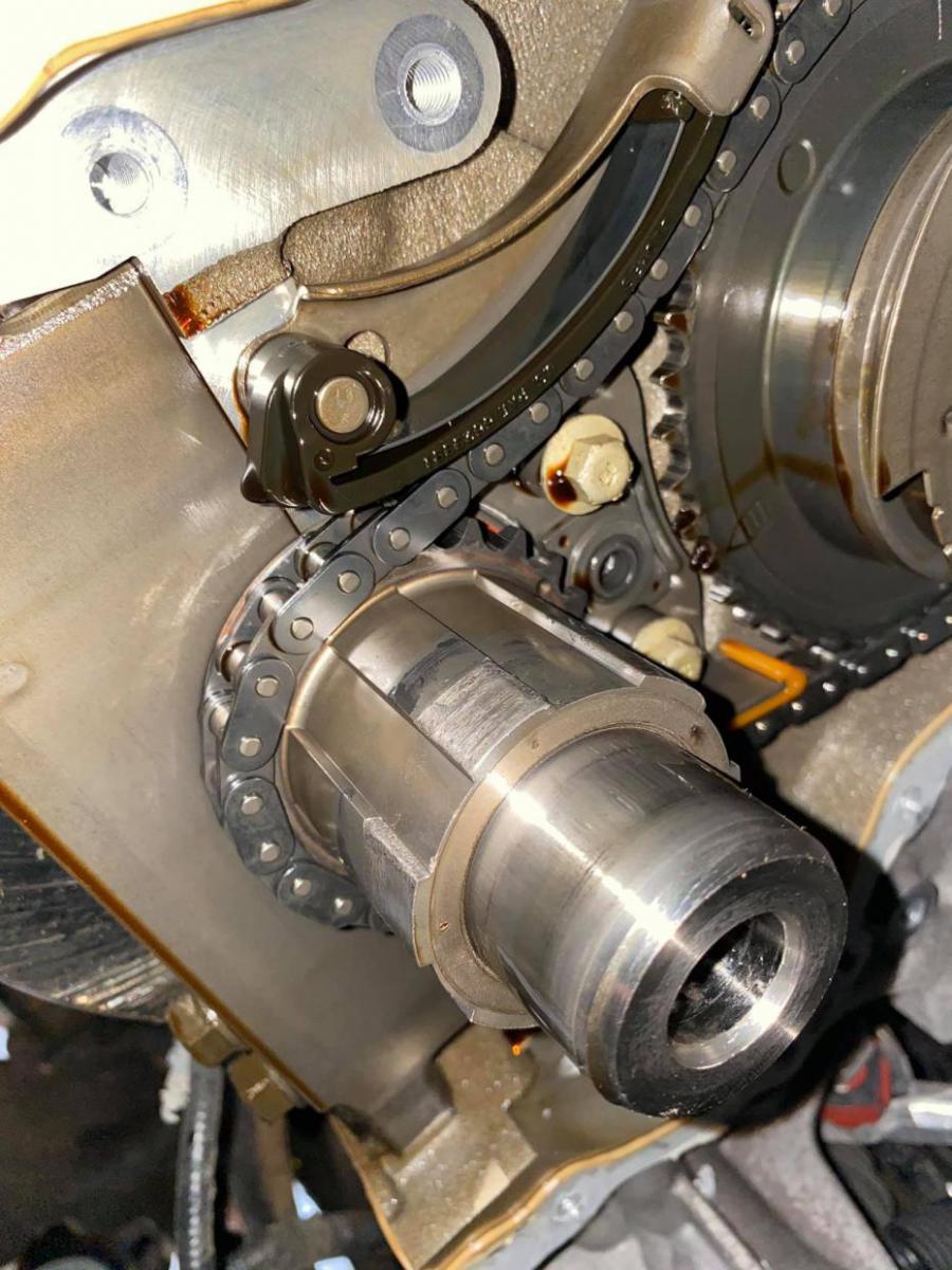

Interesting picture. I see the spring on the tensioner here... But I don't see where it rubbed the oil pump... In fact I don't see the pump at all.
This is an interesting topic, do you have any other pics?
