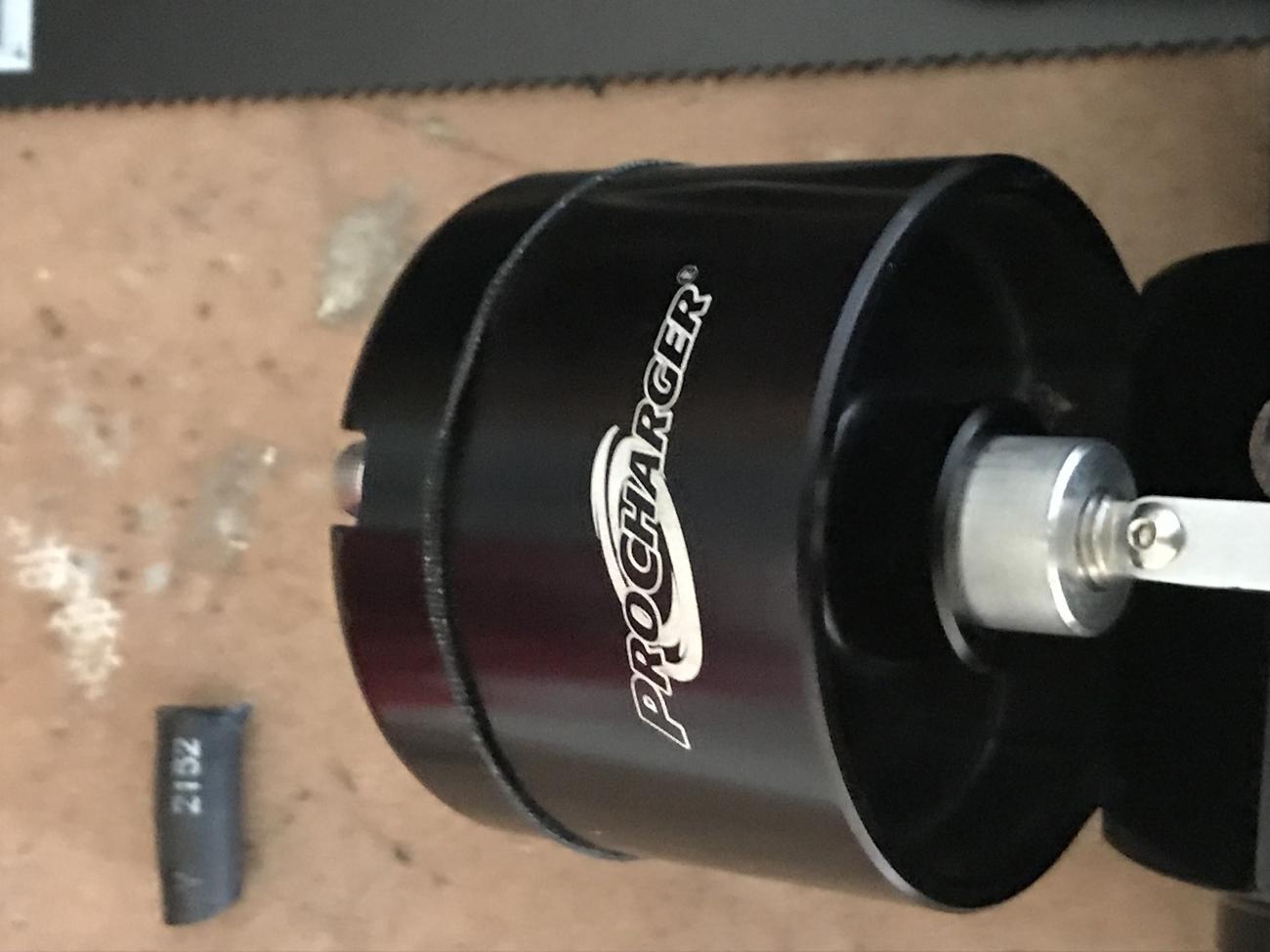

I smoke tested the system and found it to roll out of the bypass/surge valve. Not sure if that is to be expected or not? I suspected the intake but could find no leaks by that test. In the old days you could spray some brake cleaner at each intake port and see if idle or sound changed. Is that still effective on modern cars? I could also bypass the catch can system and see if that solves the issue which will be my next option.

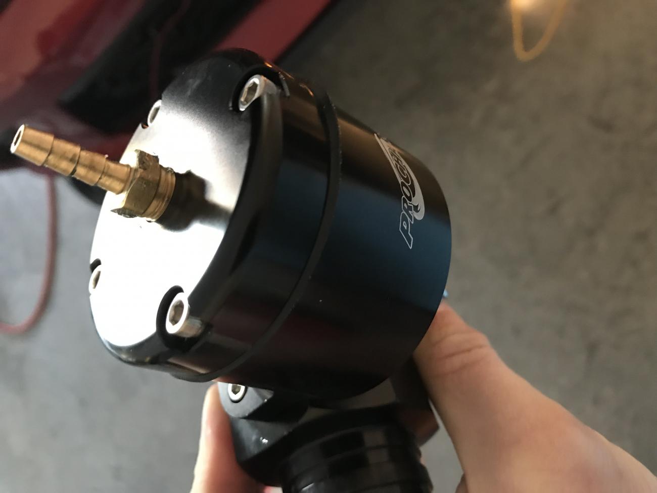

Should the gasket on the bypass valve be pushed out this much? I cant remember what it looked like before installation.
Looks about right but you can test it with a vacuum pump and see if it holds or leaks.

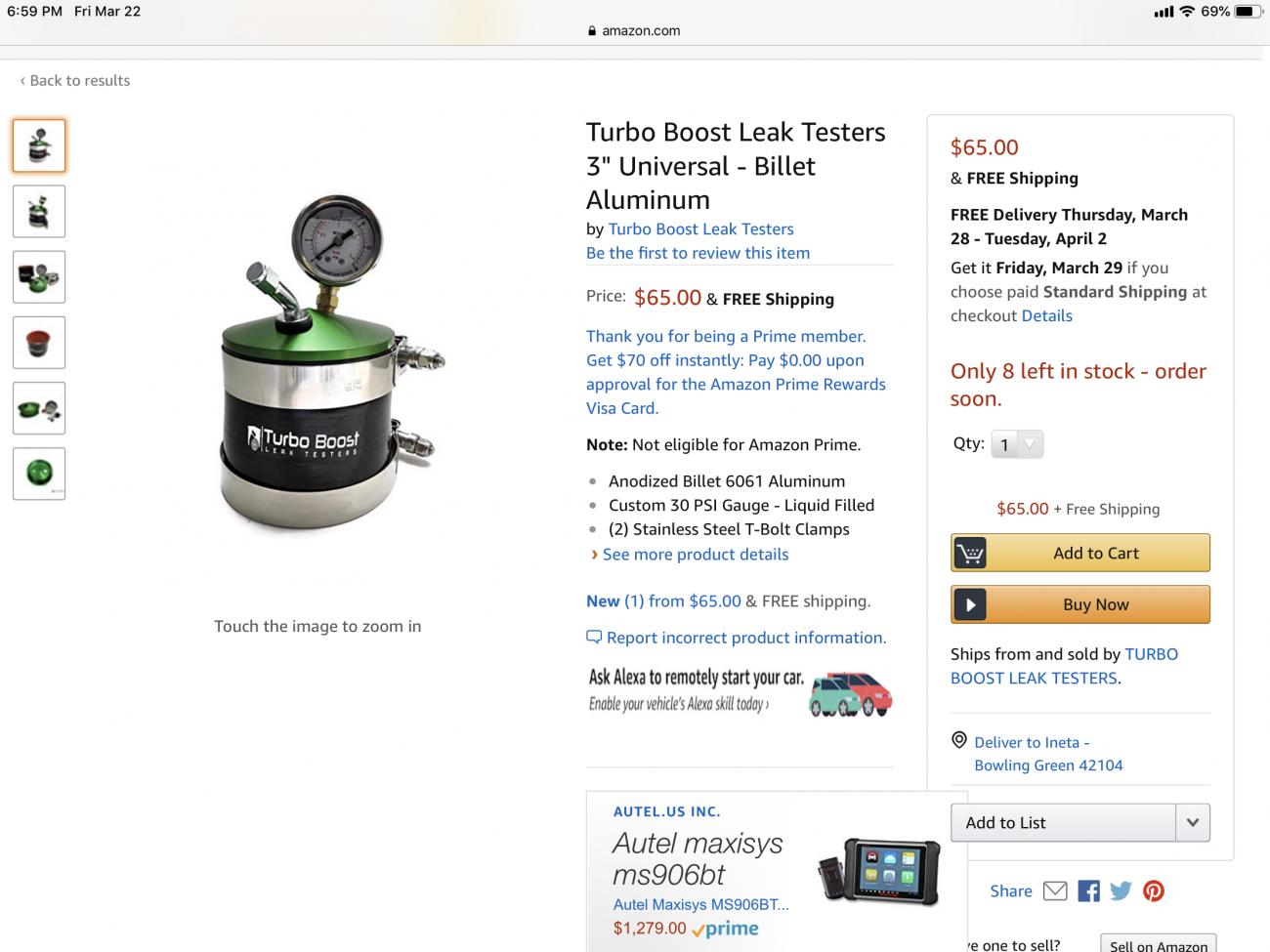

Like this but with a fitting to add air? Maybe use a pvc cap?

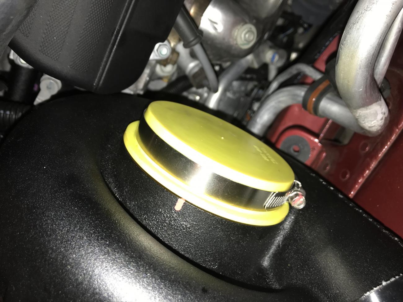

Or probably this

Originally Posted by Jfmoore79 View Post
Or probably this
Exactly

I think Ill have to make one since the most common sizes are 3.5” and 4” and the inlet size of the Procharger is 3.75

Of course it's out of stock at the moment but maybe you can locate one.
https://www.ebay.com/itm/3-5-To-3-75...-/312401911237
This is the coupler I used. One end fits the inlet on the supercharger and the 3.5in end was a common size that I could find a PVC Pipe endcap at a local hardware store to hose clamp in the inner diameter. Drill a hole at the endcap and pop in a rubber tire valve. Voila!.
