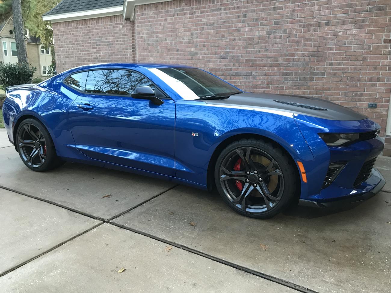

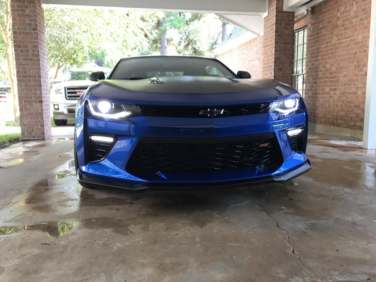

Thanks for the help, here are some pretty pics for reading

car is beautiful by the way
