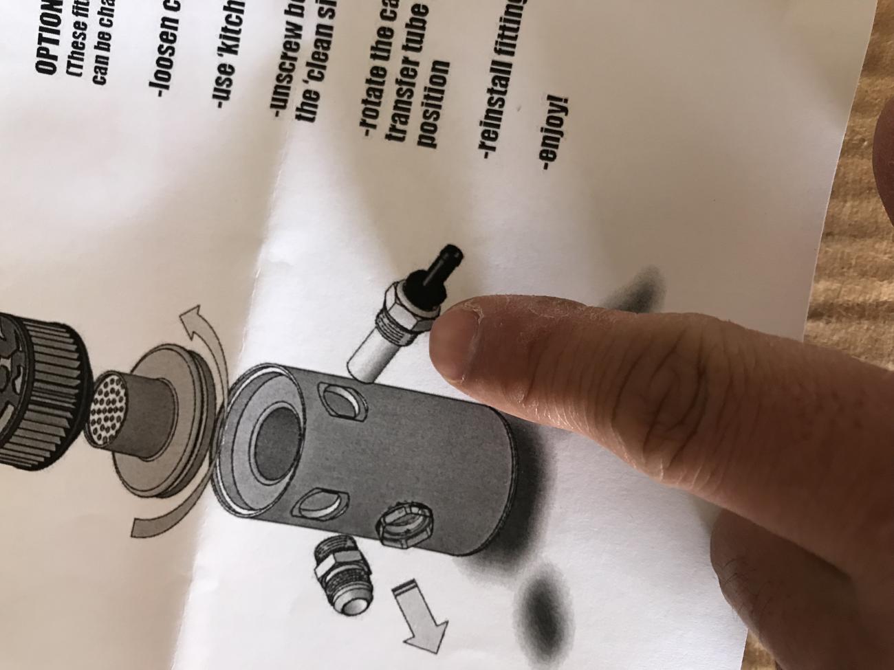

Do anyone know which side is clean and dirty side of can?

Looking at the diagram. I would say the unfiltered side is the inlet your finger is pointing at. The filtered side has the outlet port with the sight glass underneath it.

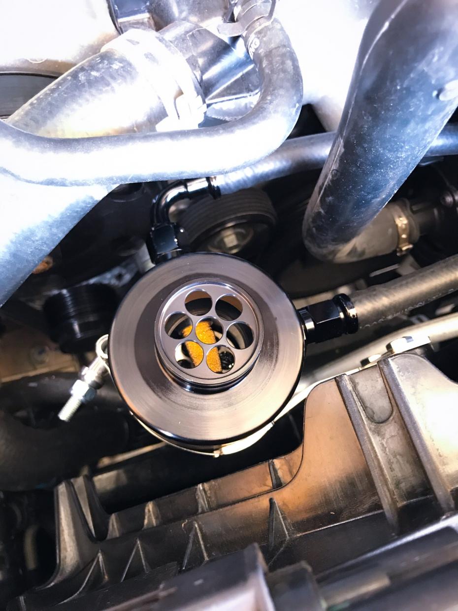

Clean, filtered side is the one with the little gold element inside.
Pop the filter off and look down inside

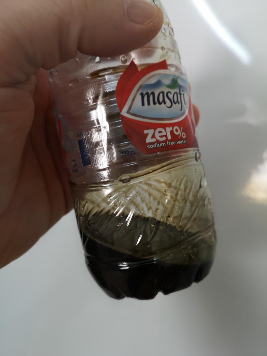

Reading this thread, so decided to go check my catch can and empty it. This is the contents after approximately 3,000 miles

Posts: 292
And even after seeing these pics some people will still tell ya catch cans are 100% worthless, lmao
