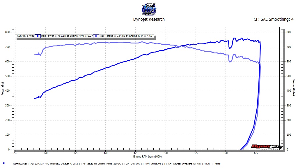

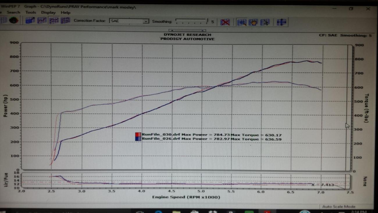

Low end torque...You decide. Here are two cars with similar power at the peak, but with completely different torque curves. For low-end, there really is no comparison. Just depends on what you are after...I think these curves speak for themselves. In this example, the procharger was running 13 psi and the Magnuson was running 12psi.
Procharger:
Magnuson:
776whp/745wtq (12psi)

Thanks everyone for the responses. That Magnuson torque curve looks impressive.
With all that power how hard is it to get a fast launch on the street? Are you always struggling to keep traction or is it pretty easy to learn the limits?

Yep. You can see the torque and power curves speak for themselves. That is primarily because with the Maggie, I step on the throttle and the boost goes to 12psi from start to finish. With the Procharger, you romp it and it starts at 4psi and builds it peaking at 13psi. As you can see, power under the curve isn’t even close until 6kRPM’s and beyond.
For the other question about traction, that’s gonna take some getting used to it. I would say that’s probably kind of individual based on how you drive. For me, 550whp-600whp is kind of the sweet spot for traction on street. That is also about the limit of your stock fuel system. To go further on the vert, it will take some planning (cam, fuel, LT headers, etc).
You get the Maggie, run 7psi and bam, you are gonna be in that 600whp neighborhood with nothing else. You figure with that setup you are running slightly more power than the stock ZL1 but with a very similar setup...so Street tires are manageable. With the automatic, I had a blast, manually shifting to 2nd get to about 40mph and hammer it. It would break loose a little and then it would hook and gone. Completely fun and manageable and no problem with fast starts or roll runs...(you will still need some practice to learn to drive your sled).

Whipple or Magnuson...works better with the M6 long gearing. The Dyno graphs posted paints clear picture. Using a 6500,rpm shift point the M6 drops back to around 4700rpm in each gear. Notice how much lower the Procharger power is @ 4700rpm compared to peak. Around 200hp drop... Then look at the Magnuson...pretty flat and not nearly as much loss(50hp) on the gear change.
On a A8 it wouldn't matter as much because of the tighter shift extension especially combined with a stall converter. the engine will stay up in the power much better. So Prochargers work better on the A8's.
