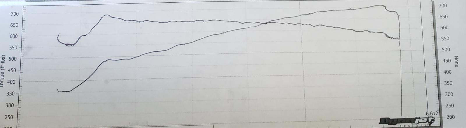

Highlights are:
705.82 whp and 698.09 wtq

I tried tracing the lines to make them visible...gotta get an electronic copy.
We only ran it to 6200rpm's, but on the street my runs have been up to 6500, so we left a little on the table with this.
We attempted a run in 6th gear, we were seeing about 20whp increase from the jump until we hit a speed limiter at 155mph. We attempted to remove the speed limiter and it didn't work, so we just hopped back on and re-ran in 5th to get the numbers above.
Bottom line is, I am very confident that my current setup in 6th run to 6500 would be closer to 725whp with only 8.5psi....Regardless, with the actual number we pulled, 705whp, that means I am running approximately 829HP to the motor! (assuming 15% loss through the A8)

It confirms that the A8 suffers a 3-4% additional drivetrain loss when compared to the M6. The M6 with the same setup was getting 730whp.

at only 8.5 PSI, looks like E85 and FI are a match made in heaven, also shows that cam 32%, lt4 high side can go to about 700 WHP, my goal is 707 next summer.

For confirmation, the A8 loses 15%? If that's the case then I'm at 642 to the crank.

The only way to know for sure is to have an engine dyno. However, we know the ZL1’s have 650HP and we typically see them dyno around 550whp. We also saw another car with the exact setup I have that ran about 4% more power to the wheels through the M6. It seems to me that 11% loss for the M6 and 15% loss for the A8 would be about right. Not the most scientific test I could conduct, but good enough for government. Besides the only actual number that matters is at the rear wheels + the ability to drive the sled, right? The engine calculation is kind of a braggin’ rights thing...
