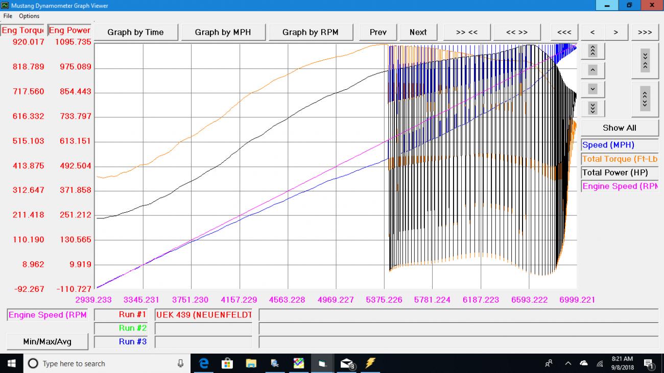

turning it up, 1095hp at 22psi
woohoo, car is making some power now. I drove it to and from the dyno, the car drives nice. this is the first time I opened the cut outs which are just 2' behind the turbos.
1095hp, 920tq at 22psi. it did lay over hard at 6700rpm. I think it is floating the valves. I may need better valve springs. I was shooting for 20psi but overshot a little. i probably wont go over 20psi on the track.
I can tell you ~900hp is a pretty good place to be on the streets. a little scary but fun and not blistering the tires at 80mph. I think anything above that will actually be slower and dangerous. now i need to get to the track and work my et down.
graph is a little glitchy.
