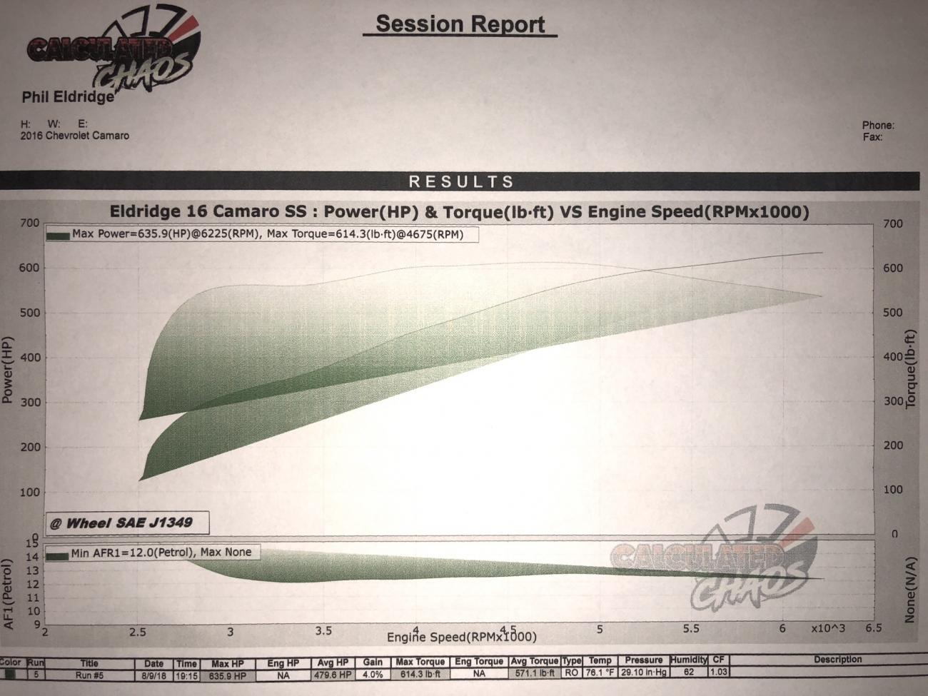

Finally some numbers!!
Had a friend of mine do some pulls for me. Whether or not it’s a “happy” dyno, I don’t really know. I’m just glad I finally have some numbers to work with. Special thanks to Ted @ Jannetty Racing for everything he has done. The tune is spot on and the car runs and drives excellent. Also thanks to everyone on this forum for the suggestions along the way. Very happy with the results and I’m fairly confident I will soon join the 10 second club!
Mods:
Procharger P1SC-1 with race IC (3.7 pulley)
Stock manifolds, catless off road pipes, stock NPP
LT4 HPFP, injectors, ZL1 in tank, FP voltage booster, 93 pump gas
Jannetty custom remote tune (Ted)

Congrats! That is awesome! You should be well on your way to 10 second club.
Do you know how much boost you are running?

Just over 10psi. I have seen it 11.5 on street logs. But that’s really only close to max RPM that it gets that high. Although, I can’t remember if that was with the stock cars restricting it or not.

Excellent, right where it should be on pump gas. Thank you for your business.

a good couch is a great upgrade for even the best marriages.. just saying. Luv the blue color.
So the car has no cats at all correct? Sound really tame compared to my car.
OK not to throw bombs, I'm just point out that the P1sc can and does put out more than double the factory torque just before 3 grand. So I honestly at least for me on street tires don't know why the PD guys keep saying that the centri lacks torque. Don't know! My car can't hook its power to the ground in the first two gears on street tires period.. I can be as gentle and roll into the power all I like, even a small centri will just eliminate any street DD radial tire at an legal speed.
Just a really great power torque curve from a P1S and a near stock install.

Most P1 dynos don't look like that. That is the best looking torque I have seen from one yet.

No cats. And I promise it’s wayyy louder than the video would make it seem. The first pull he asked if I wanted war protection and I said no. Almost dropped the phone while recording to cover my ears.
I’m not going to lie. I could believe the torque. He did 5 runs and it was pretty damn consistent too though. Maybe it’s Teds magical tune.

I think the smaller pulley is just spinning the supercharger into its sweet zone that much sooner.... yet there is still good head room at the top for serious HP... It would be cool if the same shop can overlay a stock ZL1 dyno over this one.
