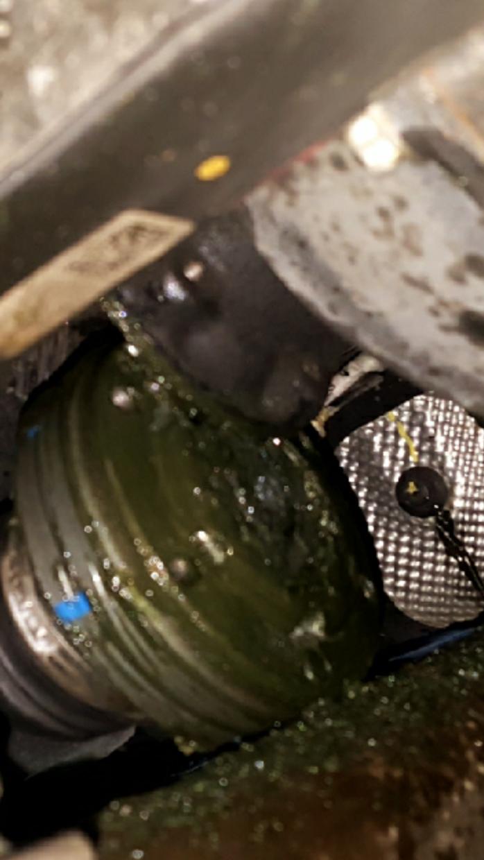

Anyone broke their Drivers side axle or half shaft..
Can the axle break due to bolts backing out? what's the chances of coverage at 36,997 miles.

Happened to me not too long ago. I had 21k Miles on it
Bolts came out. Have them replace them with longer bolts. I know there’s a TSB for it.
TSB # 16-NA-399

Mine literally just blew up yesterday driving home found this while searching for other people with the issue. I'm hoping it was just half shaft and not diff but it looked like bolts were loose because they came out very clean and didn't shear or break in the hockey puck looking thing

All but one bolt left all looked to back out.. the last one sheared off.

The bolts are all marked with blue paint pen from the factory I kinda make it a habit to look at them every once in a while and make sure none of them have moved.

Fangool, I’m going under the car tonight. Wanted to wait for the next oil change but better than getting stuck
Edit: paint on the bolts are still aligned on both axles. 1/2016 build date

My left axle broke a few weeks ago at 23,000 miles and was replaced under warranty. The service guy said it was a known issue.
I would hope it would be covered under the 60K miles powertrain warranty.

Btw.. a symptom might be when you accelerate hard on the highway like a 3rd gear pull when tires to dont break loose.. the rear feels a little loose. That's the only thing I noticed, took in a month ago they replaced both rear shocks and alignment. Guess they didn't even look at that part.
