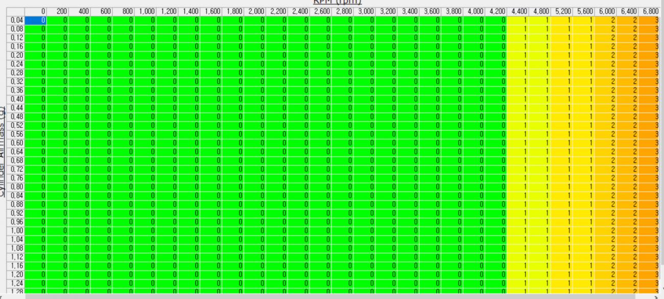

I am using TSP stage 1 cam with Whipple.
From the maker, I was advised to use the table below in Name:  KakaoTalk_20180701_205439132.jpg
but to use all zero'd for WOT condition.
I am wondering why is that. Isn't it more efficient to use the VVT at high rev? for both partial and WOT?

24 with boost? DANG SON, that's aggressive.
Most aftermarket cams run "0" since the camshaft is designed that way.
The stock cam is totally different and needs to move to be efficient down low, and up high.
If you are "0" at WOT, I see literally nearly ZERO reason why you would have your baro tables set up to go 1,1,1,1,2,3,.... since the chances of you being that high in the RPM without being in WOT is very very slim. (like free-reving in the parking lot)
However, its usually best to run what the cam maker wants you to run.
NOTE: Personally I remove all VVT from these cars, and run strait lock outs. (not limiters, but lock outs)
