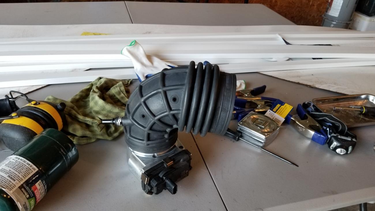

So I'm switching from the 90mm TB to a 102 Nick Williams. Not sure how I'm going to stretch the 90mm elbow for my Maggie over the 102mm opening. I didn't see anything on Katechs website for this. What have others done in this situation?

Katechs said 92mm elbow will be streched and fit on 103mm TB..surprisingly. Not sure, but I will try next week.

Stretching it will work. That is what I had to do. Use a small polymer interior tool and roll it onto the throttle body.

I'm going to try the stretching thingy, but also looking on ebay for a 4" 90 degree silicone elbow. They are about 12 to 15 bucks. I'll try this weekend to stretch it first since I have two stock elbow to work with. I post my results.

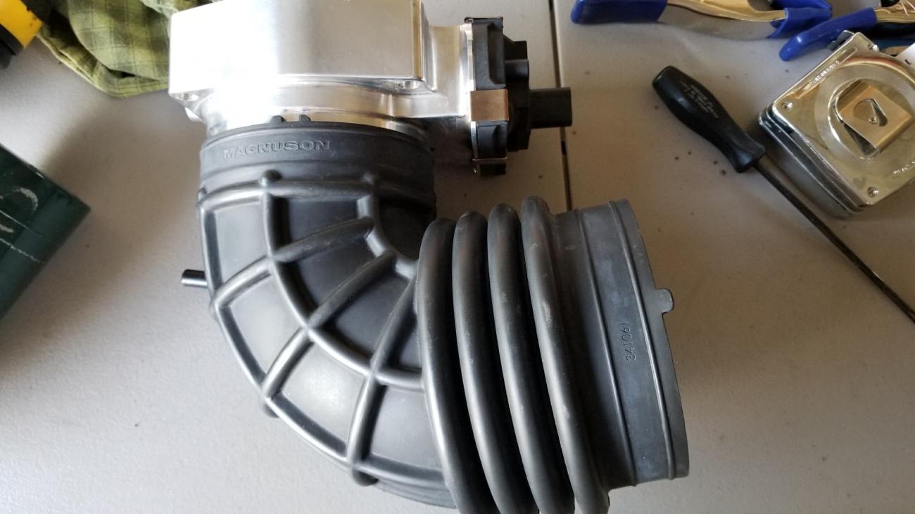

Here are the pictures from Laynlo’s setup:

Mine came from Magnuson, its ported to fit the NW TB. Its done and I've fired it up and waiting for my new tune from Mike at Magnuson. I'll drive it tomorrow night after I load the tune on my HP tuners.
