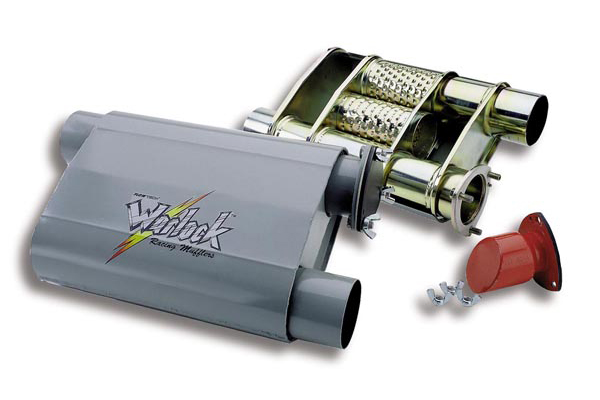

He means something like this muffler from flowtech. Notice the straight through side...
