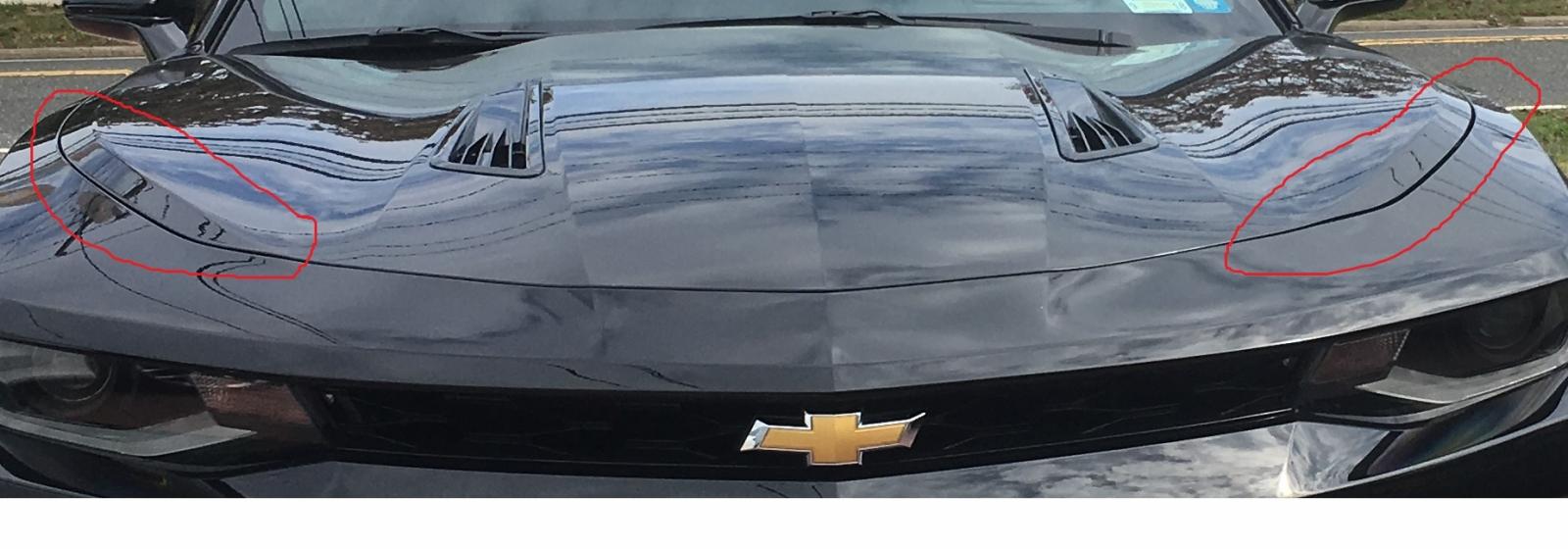

Noticed Uneven hood gap between left and right fender and hood ....Don't think this was there when I bought the car (Verified with Pics to confirm) Has anybody witnessed this issue with their Cars?

Open your hood and close it again being mindful of that and see if it corrects itself.

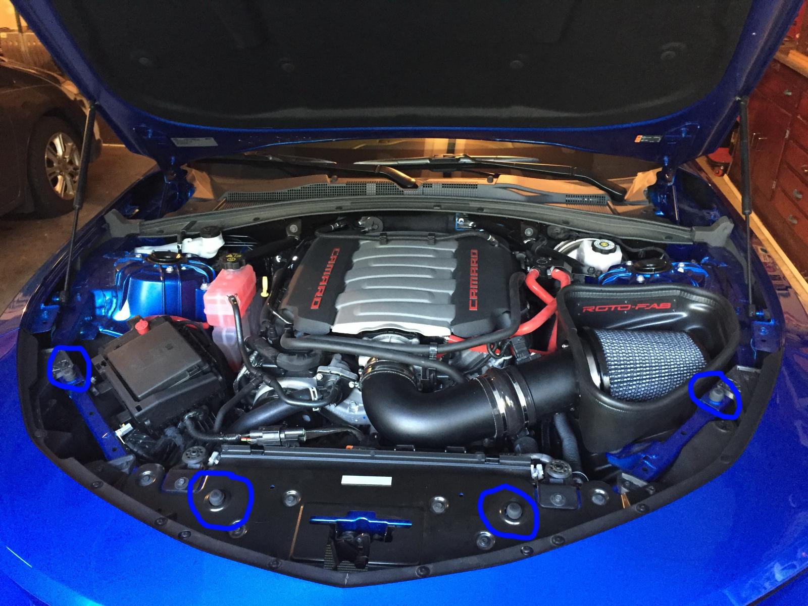

I have a Roto-Fab CAI also. My hood was misaligned so I played with the four nubs until it sat properly.
Photo of my engine bay -

I did look at your post and did play a lot with those four nubs but it did not help ....I even removed the Roto-fab Air box and closed the hood to see if that's what is causing the issue but that didn't help either, I guess I will have to take it to a body shop to get it looked at....

I posted the same last week. Adjusting the 4 nubs didn't help and neither did a nearby (not original) dealer. I had to get a 13mm wrench and adjust the hood latch. I believe they are loose when delivered and go down when closed after a few times.

Yeah, I found out that those nubs don't adjust the front very well. However, if the side lifts up a little (until the CAI settles in ) the side nubs work well to adjust. How far did you have to raise the hood latch to make it even?
