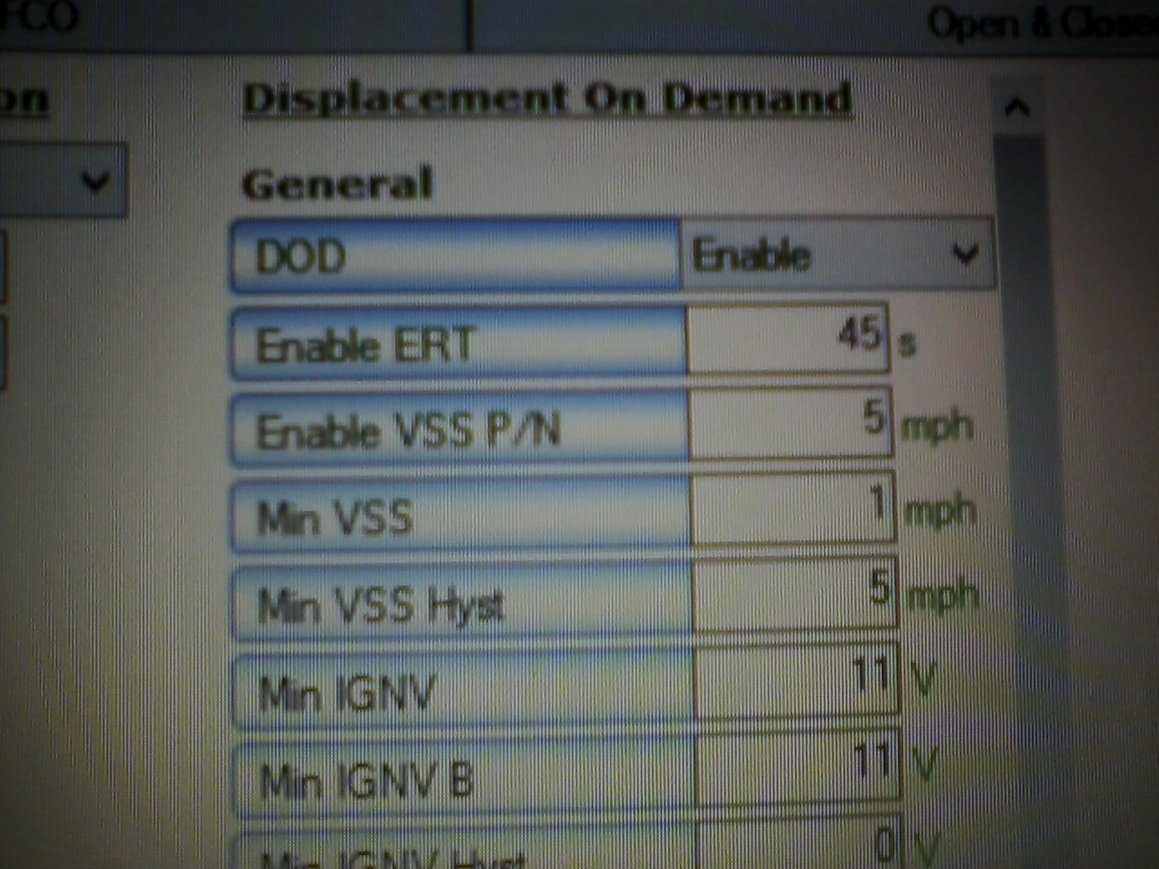

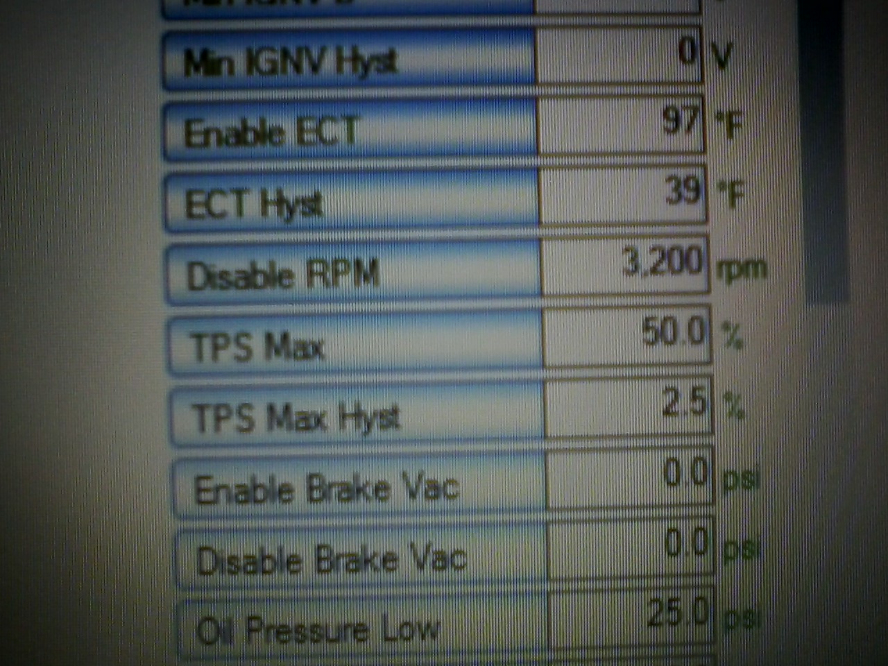

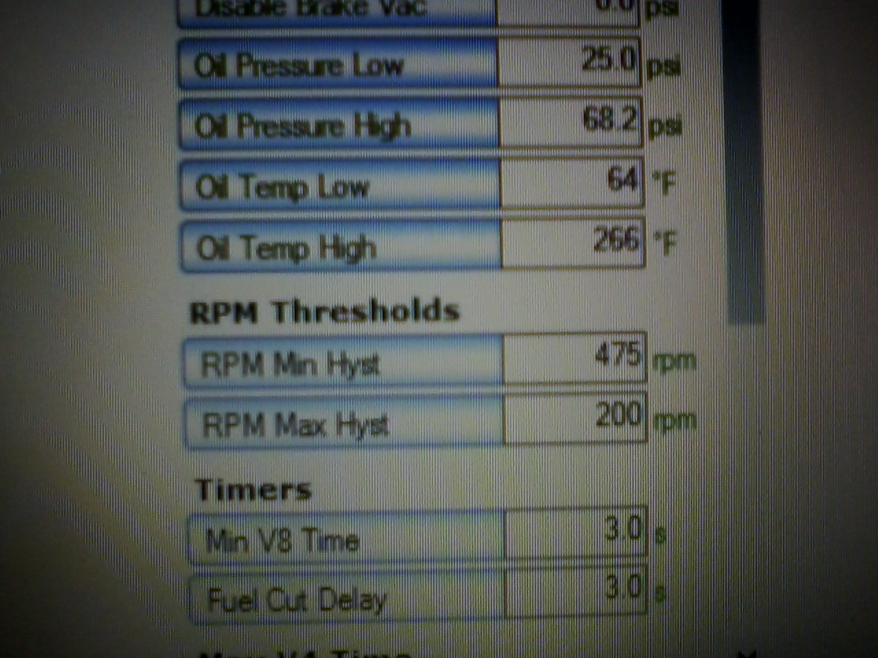

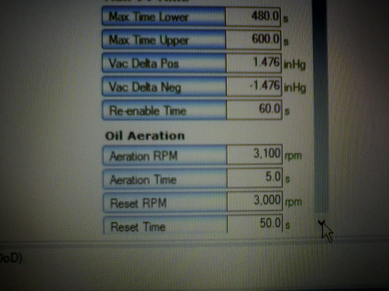

I DID SOME RESEARCH AND FROM WHAT I FOUND CHEVY IS GOING TO DOD INSTEAD OF AFM BECAUSE IT EASIER TO PUT INTO PLACE BECAUSE IT DOESN'T REQUIRE ANY HARDWARE IT'S SOFTWARE. IF YOU CHECK CHEVY'S PART LOOKUP THE 2015 CORVETTE WITH THE LT1 THAT USED AFM LIFTERS ARE DISCONTINUED WHICH LEADS ME TO BELEIVE THEY ARE ONLY USING DOD ON AUTO'S AND MANUALS. I ATTACHED SOME PICTURES BELOW TO SHOW THE SETTINGS FOR DOD (STOCK SETTINGS) WHICH THEY ACT THE SAME WAY AS AFM WITHOUT THE LIFTERS AND VALLEY PLATE AS FAR AS I CAN TELL. I HOPE THIS HELPS, I'M NO EXPERT, WORKING OFF WHAT I SEE AND READ.
JRS is offline   Reply With Quote

Thank you. Appreciate the pictures too, they are a big help.

DOD and AFM are the same thing. Chevy is not going to DOD. DOD is just what it was called first, then it was renamed AFM. No parts have been discontinued, maybe updated or a new part number but I haven't looked into it. The AFM lifters are still being used and will be for a long time into the foreseeable future. This isn't just a software thing. The reason your tables say DOD instead of AFM is because it's the same thing. I've got an auto and the tables say DOD too. It's the same thing
