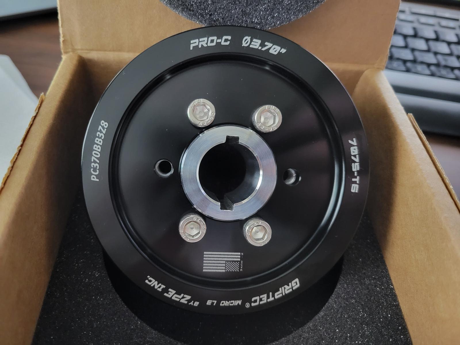

Got this guy, but won't be going on for a while.

I got a few of those myself. Andrew does a great job at Griptech and can build about any size you want.
