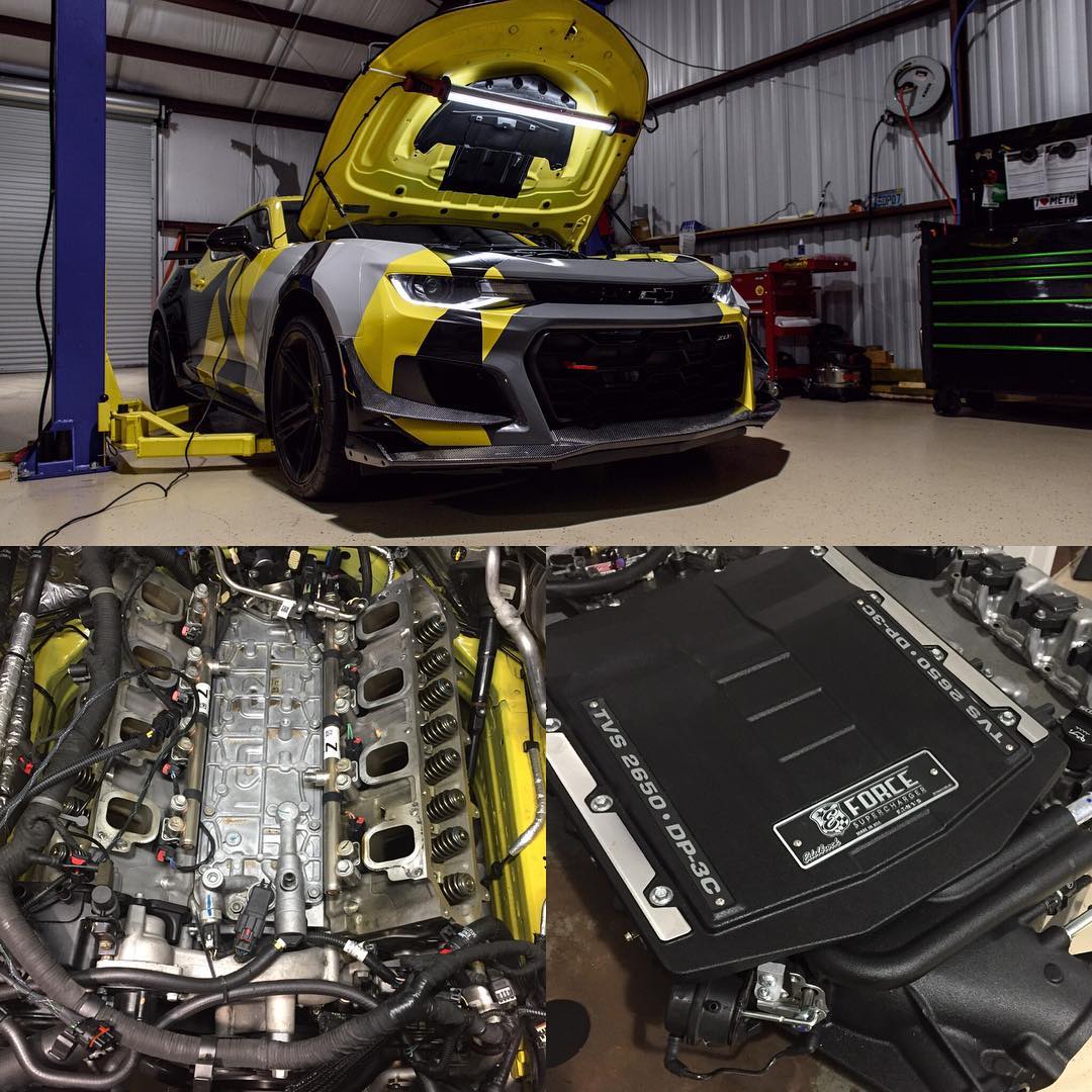

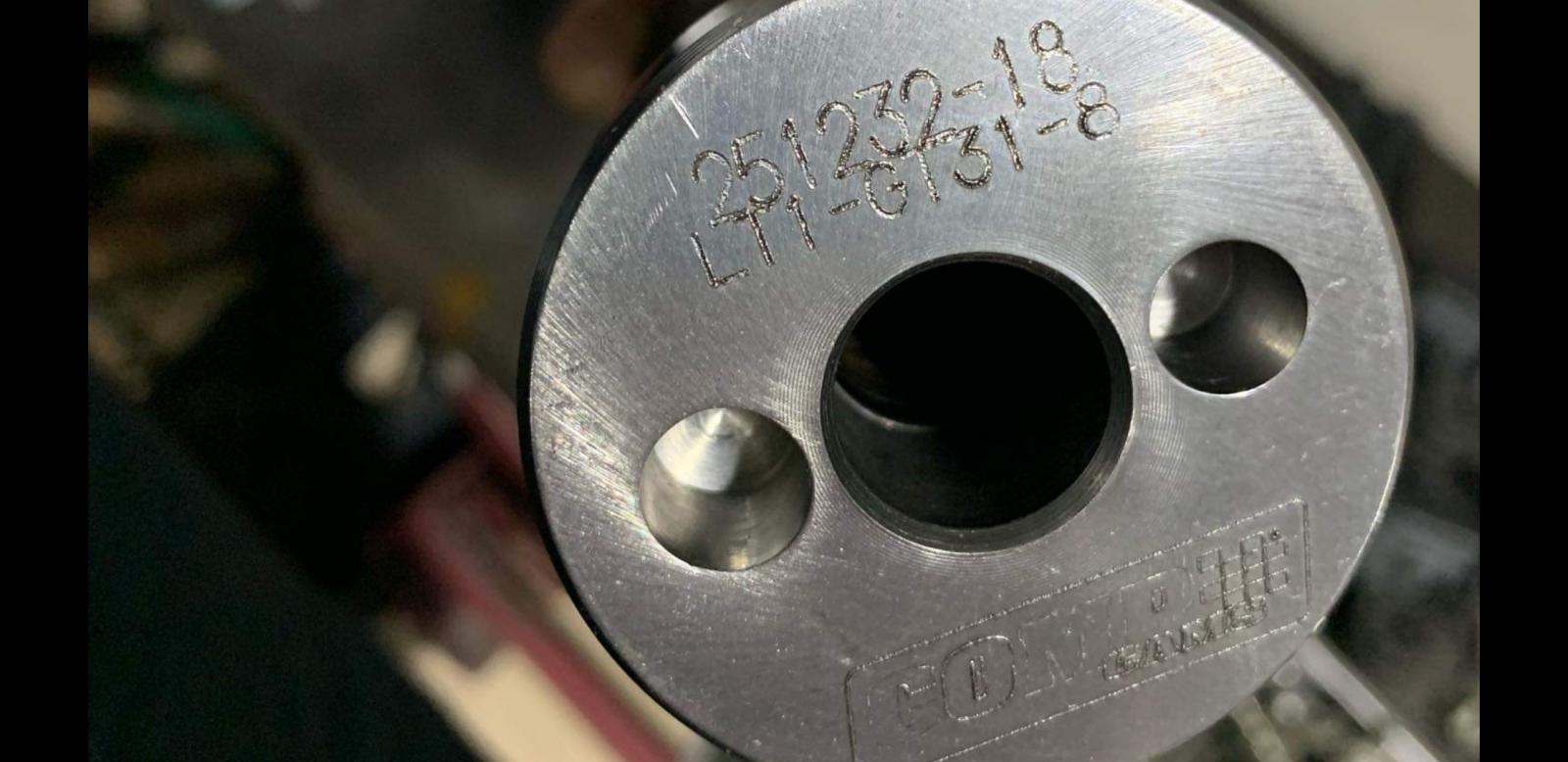

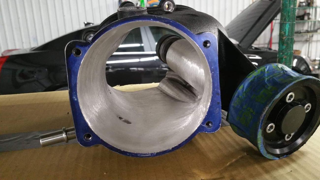

Heads are off and on the way to be ported.. CNC, hand blend and valve job.. 690 Springs, titanium retainers and stainless exhaust valves will be added along with the LPE GT31 cam.

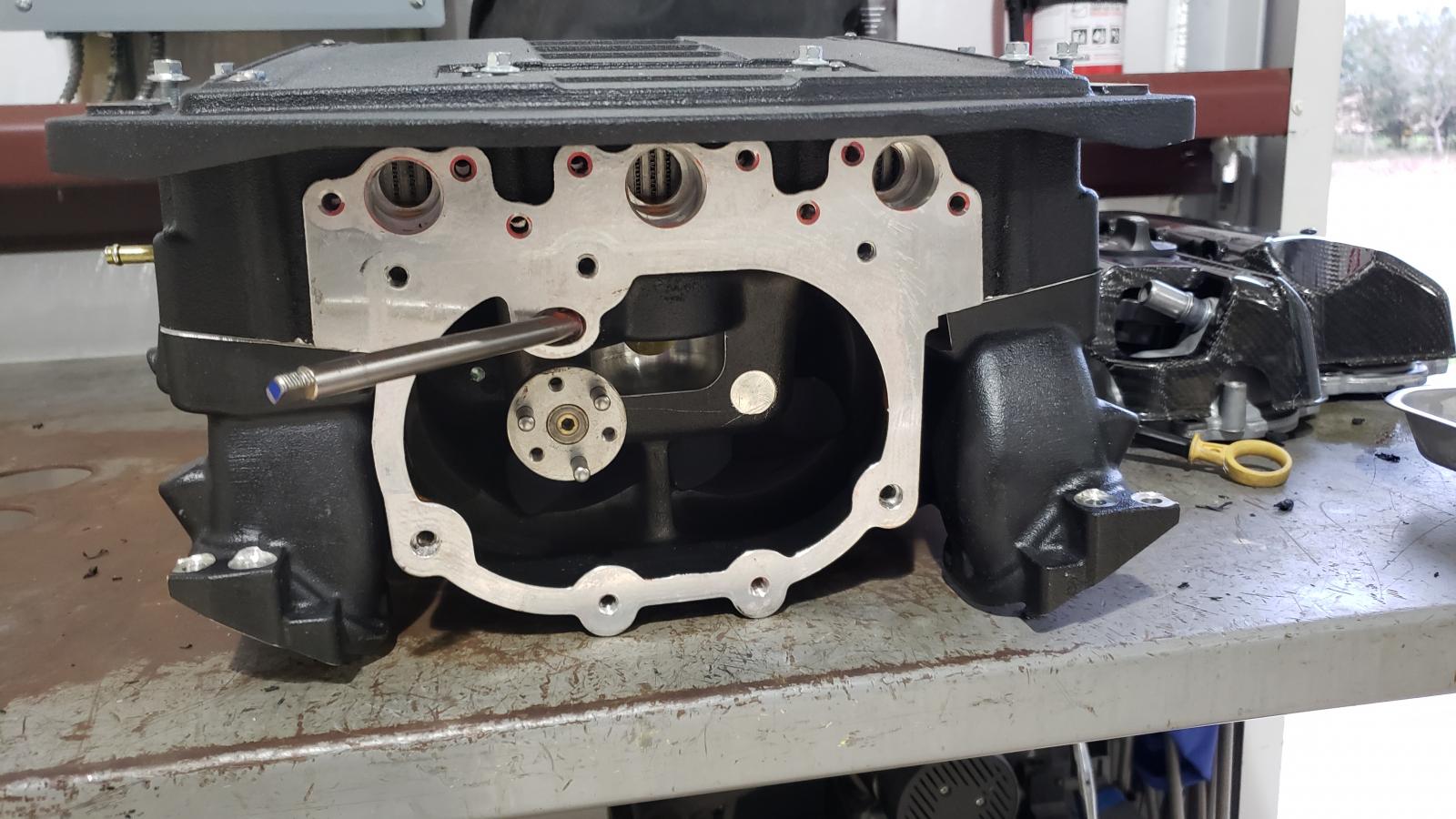

2650 Snout on the way to Boost Mode Racing David is local and has some of the fastest OEM LSA and LT4 cars around.
Snout measured 102.3mm it will be opened to 112mm or 4.41 inches. Then fitted with the 112mm NW TB. This could be the key to letting this thing breathe. Looks like there is plenty of room before getting near the threads.

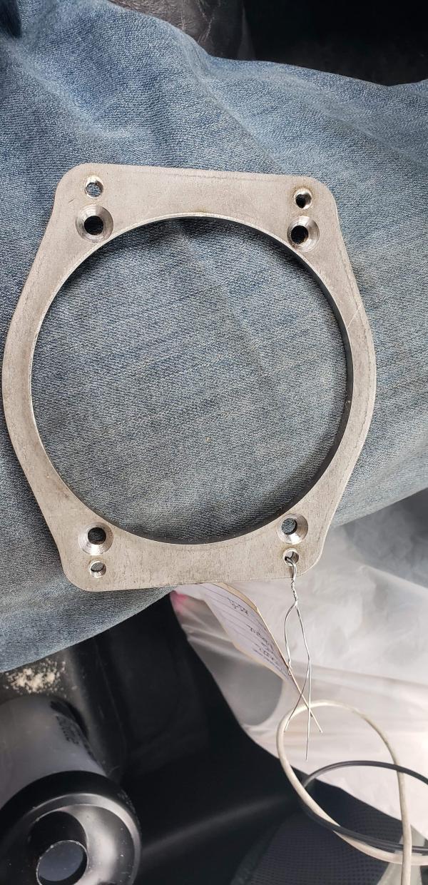

Adapter or spacer will need to sub out??? Donde???

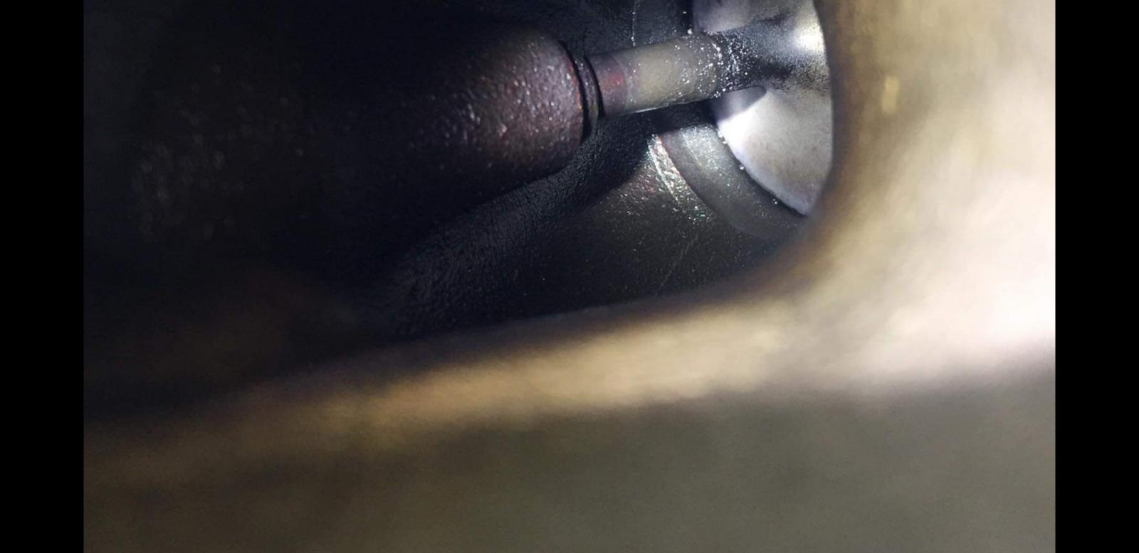

There is a pic of 20k Miles with no can on the worse intake valve. And combustion chamber using only 93 octane..

nothing will align that big with stock bolt pattern.. there are some 109s for the copo but they aren't designed for the street really, they would not idle great and you probably couldn't leave the stop light without laying a 10ft burn out every time..
This is all testing shizzy, the people working on my car have good relations with each other they have been in the racing scene for 25 plus years on big projects like copo and others .. we are testing for a few companies everything will be data logged and information will be given to them.. Sorian has tons of data all ready just on the stock blower setup..
That Vararam intake is no joke he does a lot work for manufactures and race teams, I had the small no tune version on a car that all ready was tuned so it wasn't like buying a cold air then tuning on it and and some of the power is the tune and some of the power is the intake..
Going by Edelbrock findings the 112mm should really help but so will the cam and heads..

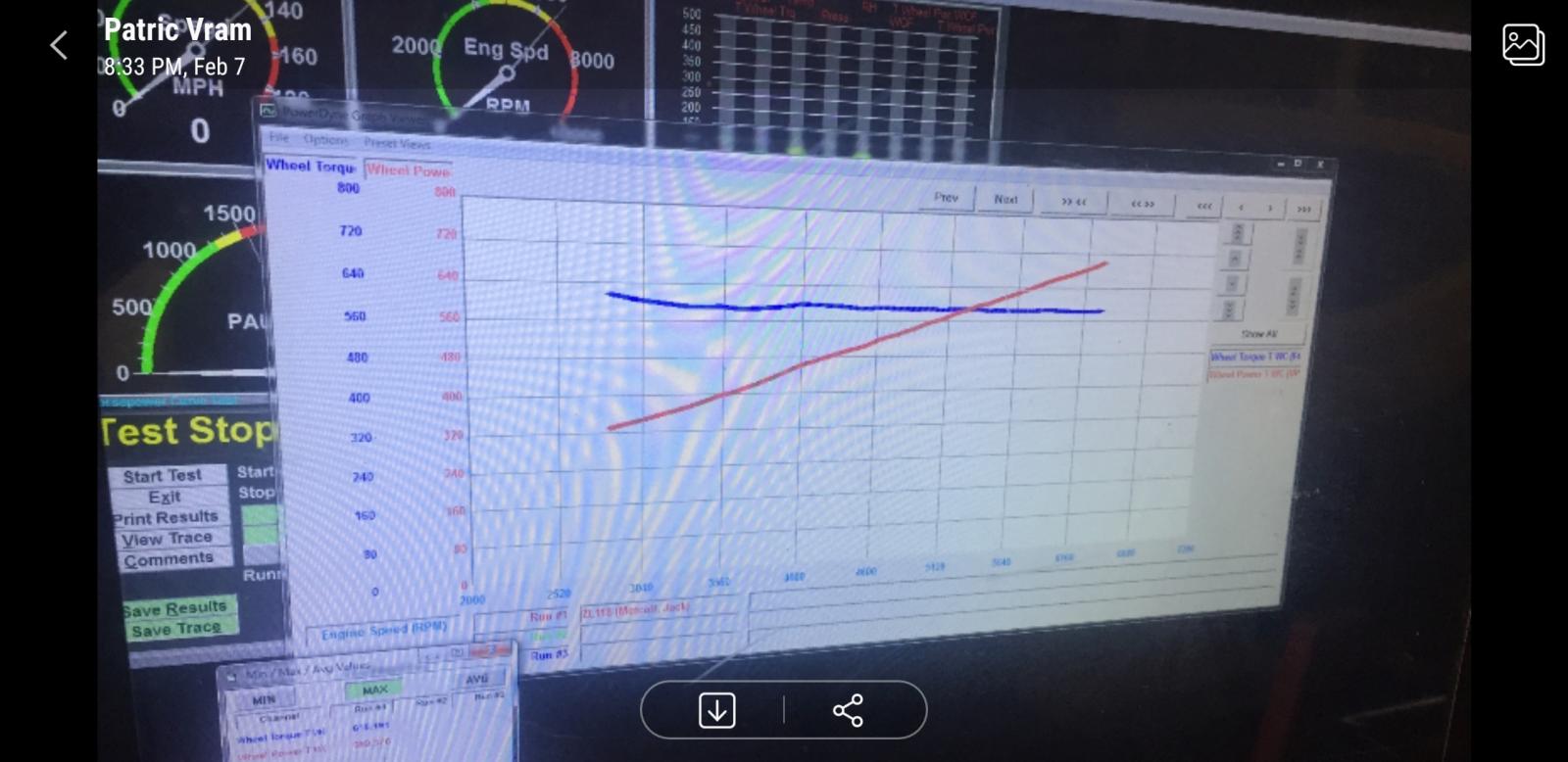

Snapped this today of the blower while picking up wifes car.. 613 RWHP 663 RWTQ eforce 2300 with my old fuel parts and 1 3/4 headers..
Also the mustang dyno screen for the 2650 blower w Vararam intake and NW 103mm.

About to Stab the GT31 cam in cam lock out not a limiter in big builds the limiter tend to move around in high hp applications.

By no means finished... just sent me an update..

The adapter from boostworks!
