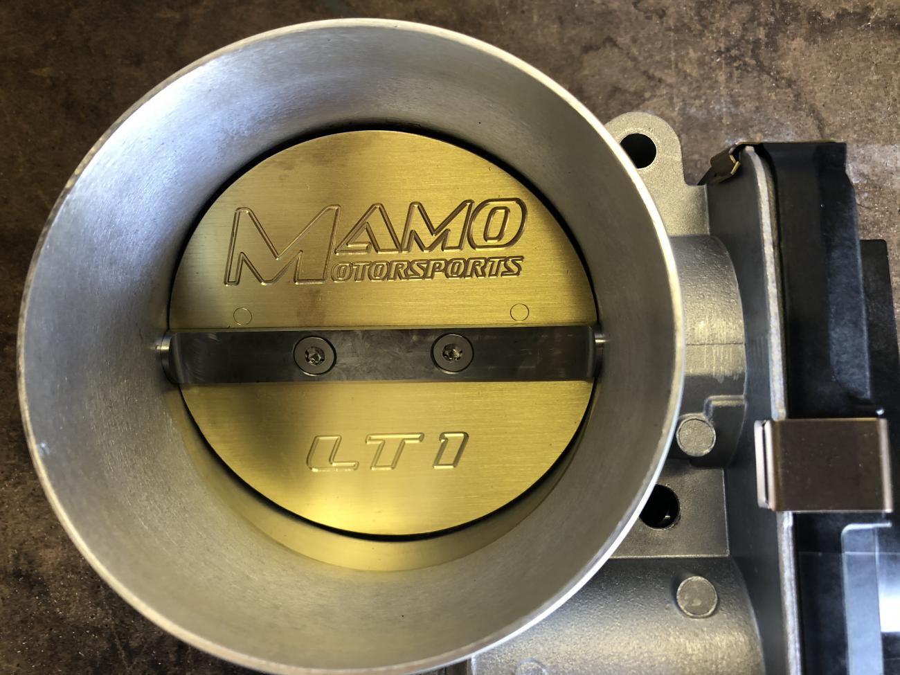

Well its installed. Hardest part is the intake tube and getting out of the way. I would suggest that before you do this you take the car to the spray wash and wash your engine compartment. I thought mine was clean but by the time I was done I was amazed at how much dirt was on my hands. Getting the throttlebody off with the four bolts was actually quite easy and I really had no trouble with the connector I took a screwdriver and I hooked onto the clip on the bottom started the off it came. Throttle response is very much improved and I’m sure it’s gonna get better as the ECM learns the new throttlebody but I can already tell that I don’t have to worry about pulling out into traffic anymore.

I installed mine Saturday but my car is one of those problem childs. Tony said to give it some time to learn but after driving all weekend it’s no better. A lot of surging, poor throttle response, but great wot. I think it might be my tune from getting headers installed. It’s and email remote tune so I’m sure it needs to be tweaked. I’ll be contacting my tuner to do some data logging. Tony’s TB looks amazing with great workmanship and design. I sure hope I can get this sorted!
Did you ever mention to me it was a remote tune!?!?
(I may have forgotten if you did!)
Either way I am betting that's your issue right there. I suspect its lean in the portion of your tune controlling the lighter load (part throttle) sections of the tune.
Get that on a chassis dyno to optimize WOT power with the mods you have and more importantly have a tuner drive it (or drive around with you) and data log all the fueling in the part throttle areas your having issues with.
Or you can datalog yourself (assuming your set up to do so) and email the file to the remote tuner that helped you to have him take a look at it.
Remote tunes in general just get you in the ballpark and some just barely do that. You really need to find a local source or invest in the equipment needed (tuning software and a ideally a wideband O2 sensor installed in the exhaust) to properly data log if you want to work remotely with any type of real effectiveness.

Check my texts. My last sentence was about the email tune. I plan to call him today about data logging. I have an SCT BDX handheld to do the data logging. Depending on what he says I plan on doing a dyno tune as a backup plan. The only reason I did the email tune was I couldn’t get dyno time scheduled locally and I needed the car inspected so couldn’t have any cel’s. I’ll keep you posted. I really want this to work!

Mike.....worst case we swap it with a slightly more conservative version.....no big deal.
I think the tune is going to take care of all your issues though

Tony is doing a custom ported TB to help reduce the surging and soft response. I envy all you guys who put this on and have no problems. My car is a tough one.
