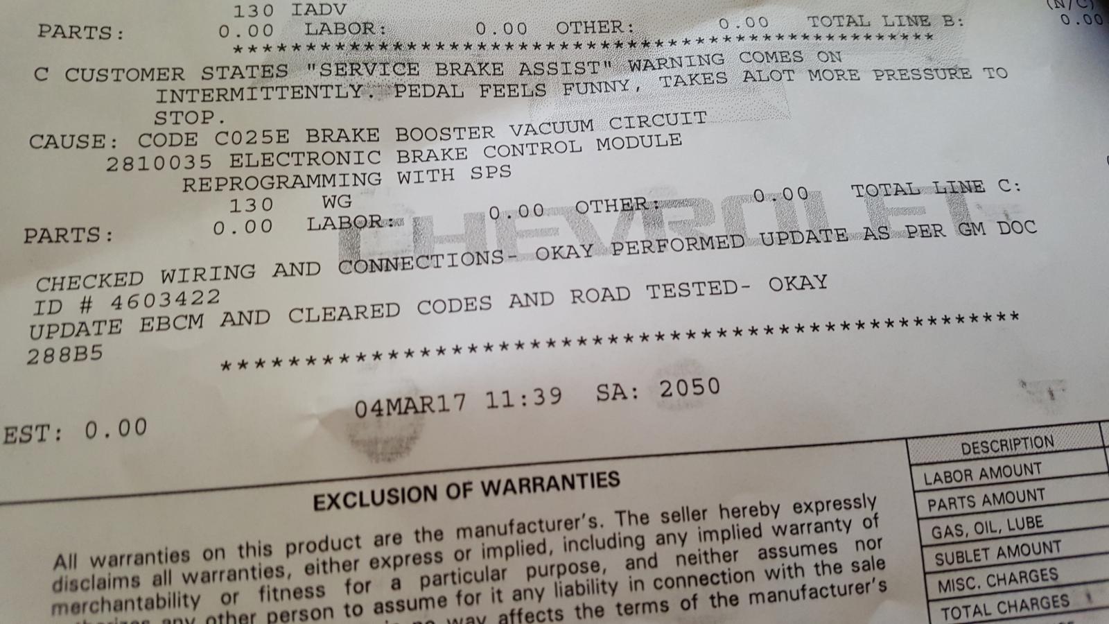

I got the "Service Brake Assist" message last night. I just turned into a parking lot at maybe 20 mph stopped to back my car into a parking spot and the break felt weird and this messaged popped up. I shut down the car, finished my work in about 10 mins got back into my car, restarted it and no issue at all. Like nothing happened.
Contacted the service rep today morning and he said if it happens again setup an appointment immediately!! This happened at 7pm. 12 hrs before the service department opens the next day. How will they even run any diagnostic checks to find the issue when the issue cannot be reproduced?

Service brake assist light came on yesterday. Brakes felt very soft and pulsating a great deal. After driving a block, I pushed dismiss and the light went off. I continued to drive slowly and the problem went away. Scary feeling not have good brakes on a car with 455 hp and no emergency hand braking system . Today I took it to the local Chevy dealer and reported the issue along with the problem of brakes pulsating over the past month, most noticeable at Hwy speeds.
Technician at dealer reports no codes but did turn the front rotors. I wanted to document this issue in case it happens again.

I went to the dealer and told them about this issue. They said there was a bulletin form GM about this issue and have reprogrammed the module with GM's update. attaching a picture of the same. Anyone who is still having this issue can show this information and maybe the dealer can help you out.
Very good.
Now...is this something that anyone can go and ask to have done, or do I have to experience the issue and have a stored code?
Its just a programming update?
