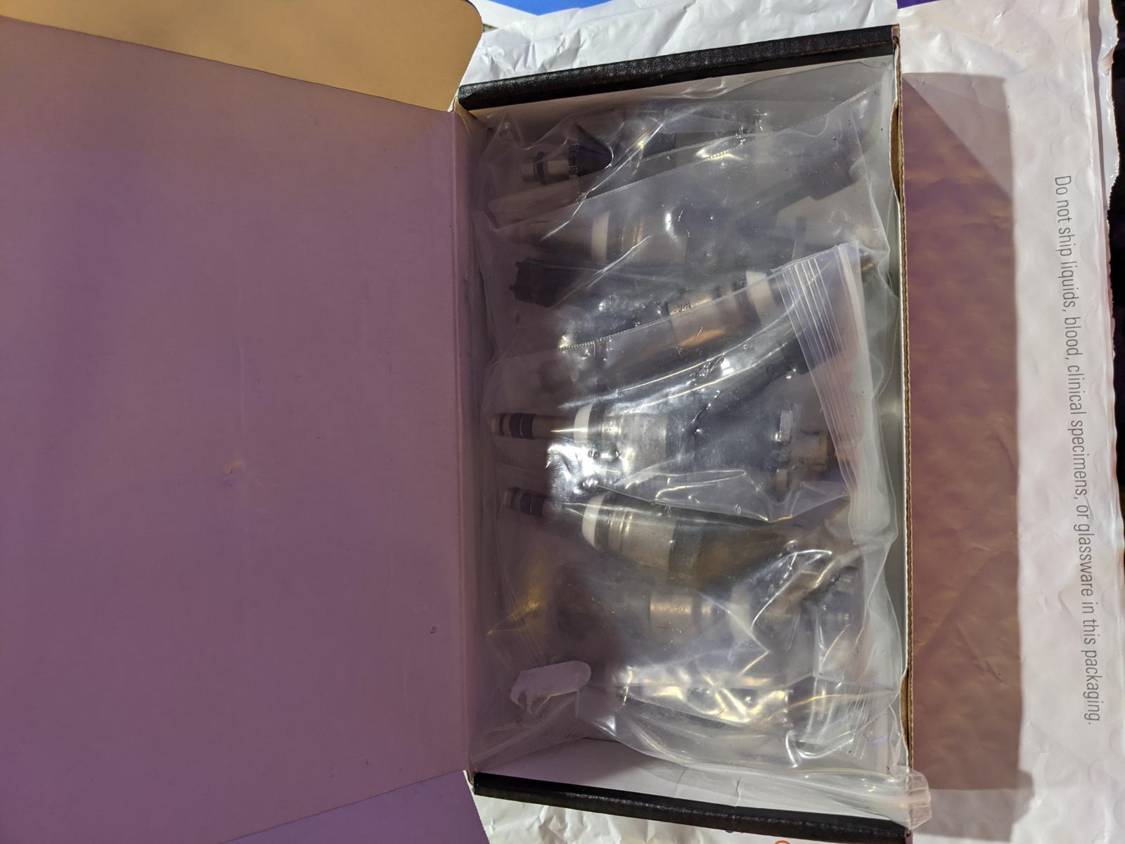

Old 05-11-2021, 07:30 PM   #54
GN_Drake
Join Date: Feb 2020
Location: Austin, TX
Posts: 70
One step closer. FIC +30 showed up. Once the engine is built I'll be shipping them to GPI. Just waiting for some kind of update to know it's being worked...
