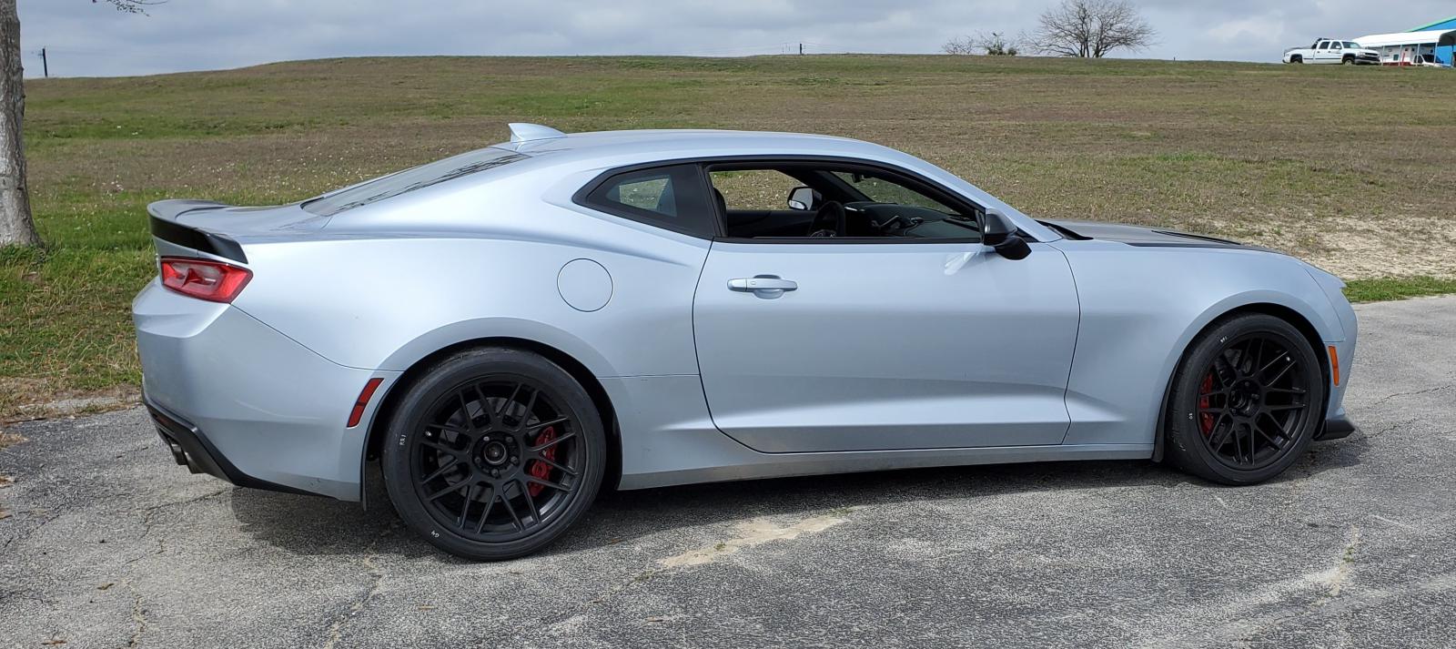

My 19x10.5 ET22 square track setup on 305 tires

So you are running a 20MM spacer on the front????
305/30/19????

20mm is an option, but I have a 5mm spacer in the front with the strut mod and longer studs. Additional strut mod gives me front -3.0 camber
