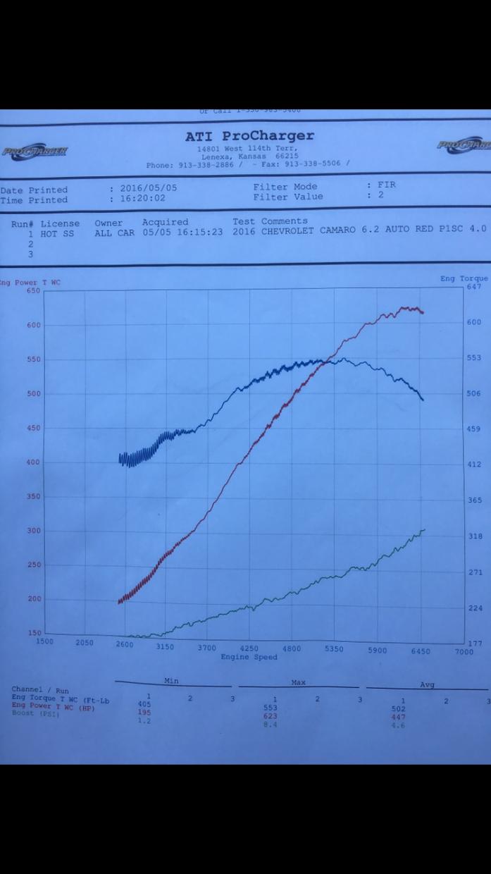

Has any one else installed a Procharger? Mine came with an SCT handheld. Put 623 to the wheel.

What else do you have done? Sounds like a lot??? Didn't figure a bone stock car with their kit and their tuning would be any more than 550 whp.
