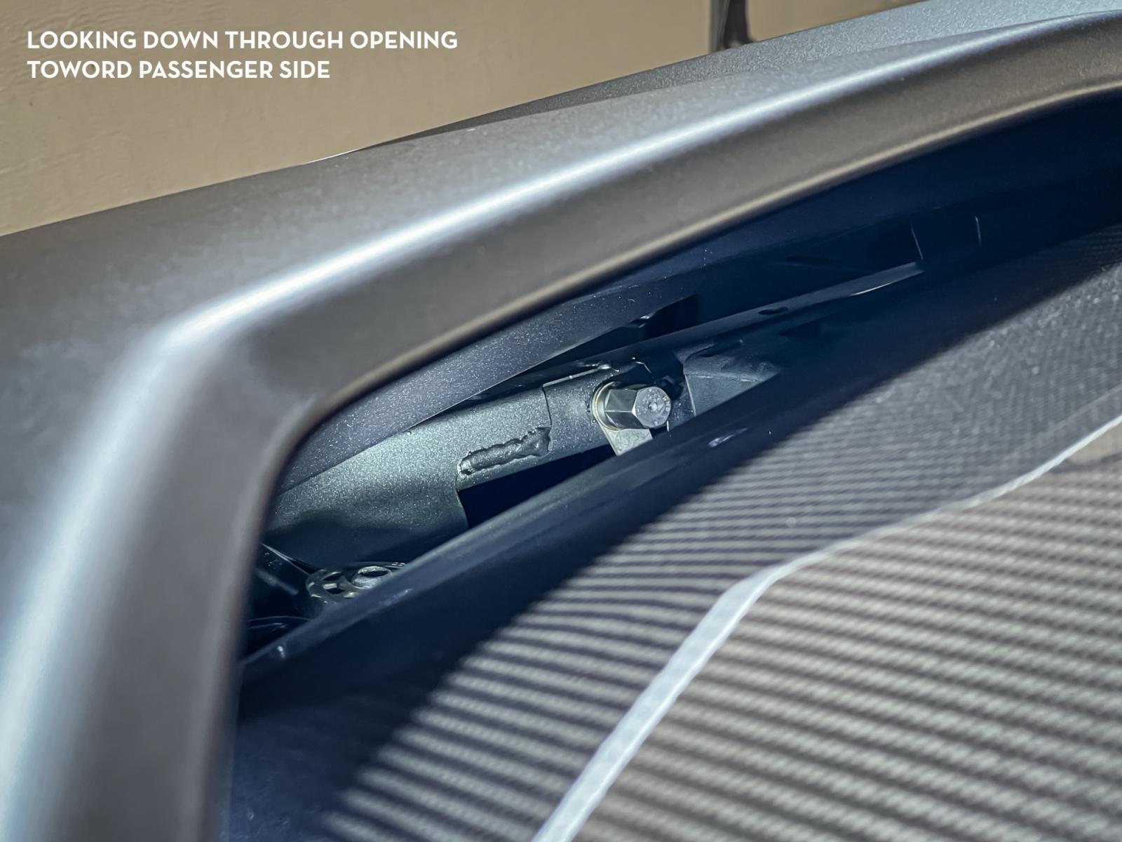

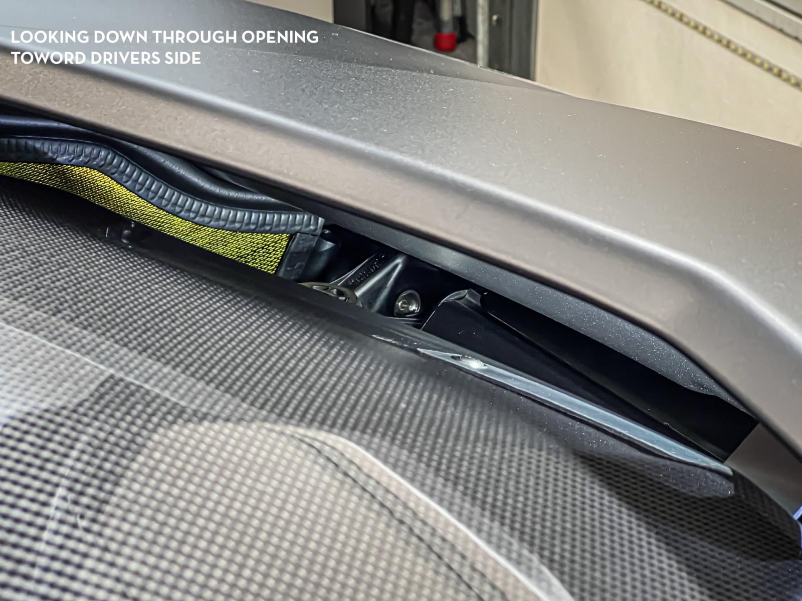

Location: San Diego CA
Posts: 2,189
Originally Posted by IndyZrider View Post
Is the rear of the insert raised as well? If so can you do the rear only without lowering the front? Not a bad idea...what does it look like with the hood closed from the sides and fro t?
Hey Indy... Good questions... a few more photos from this weekend.
Hope this helps!
Hope this helps!
Appreciate it!
