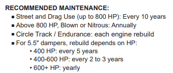

Old 12-07-2023, 07:17 AM   #34
Joshinator99
Moderator
Joshinator99's Avatar
Drives: 2017 Camaro 2SS A8
Location: New Ipswich NH
Posts: 6,336
ATI super balancer. It has the OD pulley bolted to the front. The pulley is fine, but the hub of the balancer is damaged.
Yeah on blown or nitrous cars above 800 HP they recommend an annual rebuild (<$100). It’s been a few years so I’ll probably have mine done this winter too.
First I've heard of this. You learn something new every day. Thanks.
Might my new crank require a different balancer offset?
