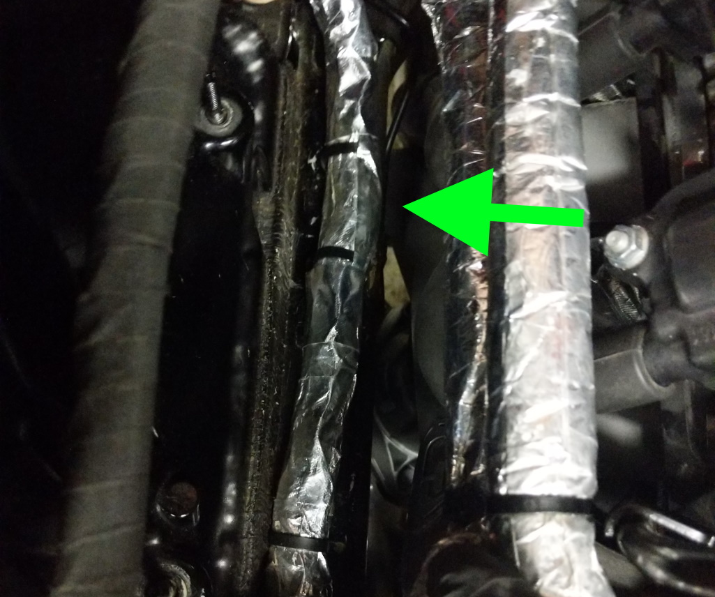

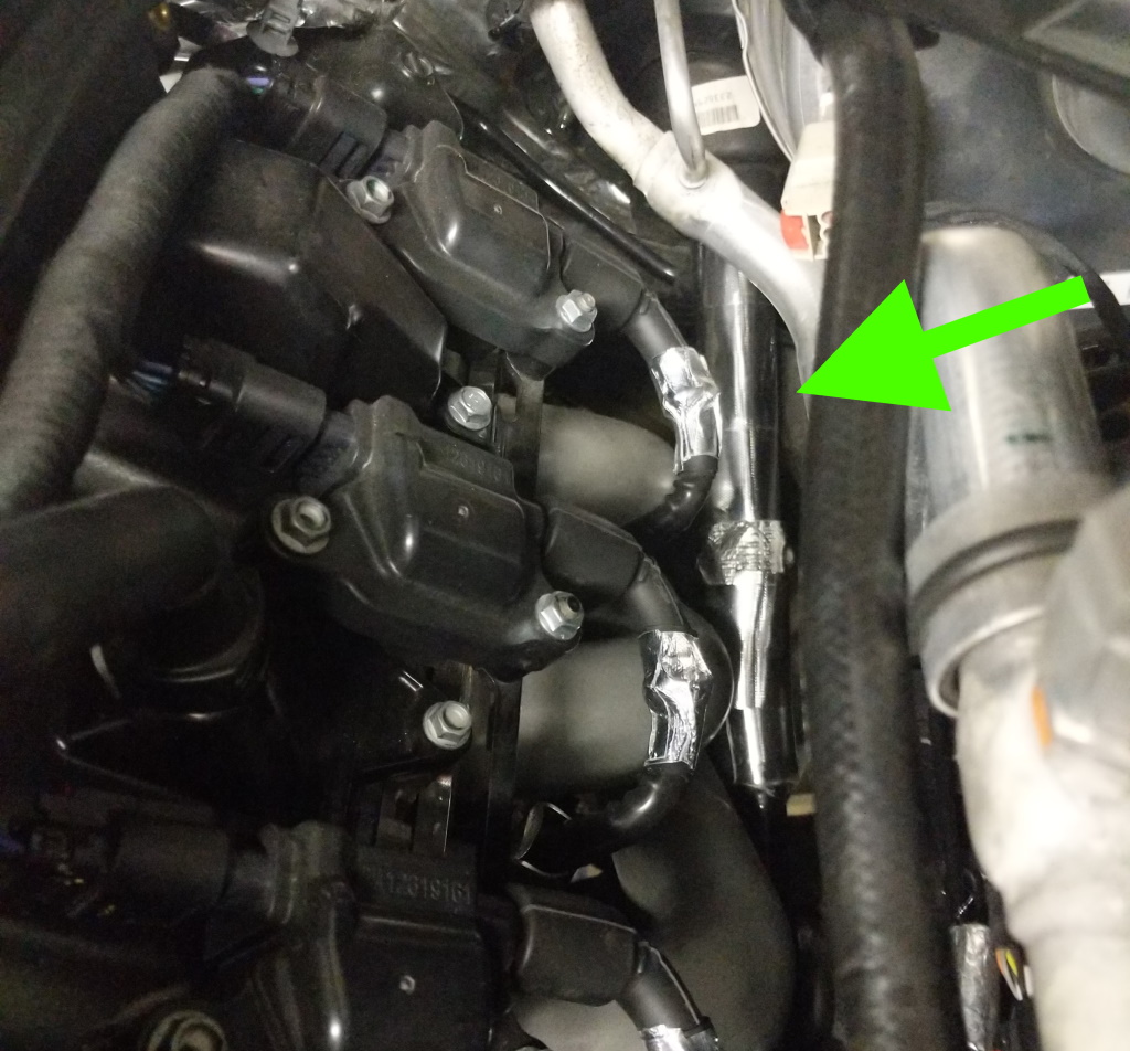

Thanks for the heads up on the issues you had. I will keep an eye out and I am going to proactively heat shield those items. Would you be able to list the specific sleeve part # from DEI that you used and give a picture of where you heat wrapped the wiring area?
I just ordered 30ft of 2" wide DEI cool tape for the moment.
Name:  Steering Shaft.jpg
Name:  Wire Harness.jpg
