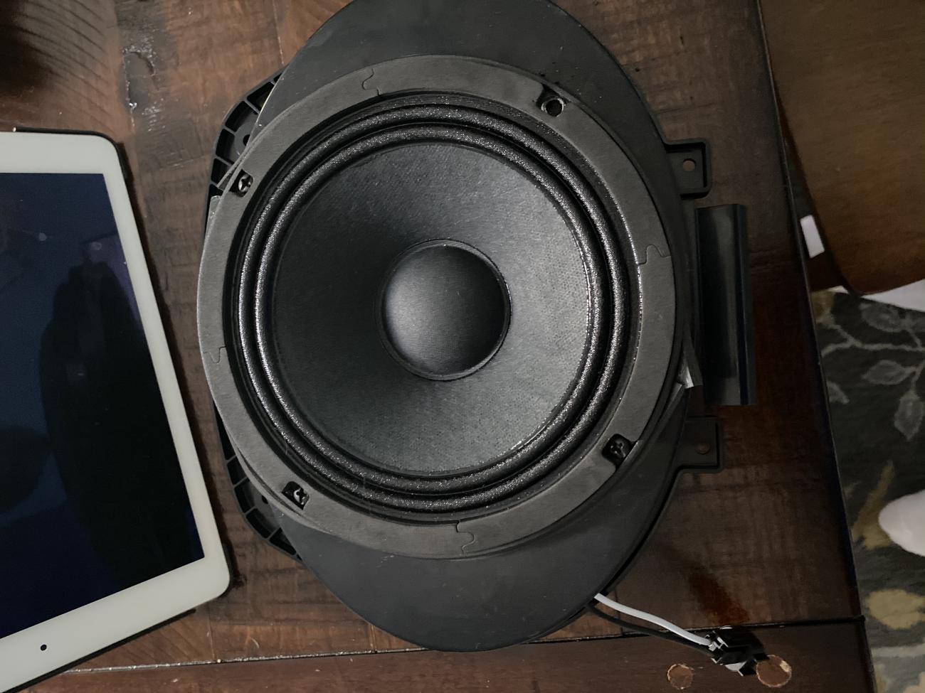

Stevens MB-6 4ohm speakers installed. I’m very happy with these speakers. Even on the stock amplifier there was a big difference vs the stock speakers. They play louder, clearer, and have much better midbass. Past halfway on the volume, the stock speakers would start distorting and sounded worse the louder you played them. The Stevens Audio speakers are the opposite, they sound better the louder you play them. They really are a bargain at their price point. I have owned Hybrid Audio, JL, JBL, Rockford Fosgate, and Morels. The Morel midbass woofers were my favorite, but these are right there for me in terms of clarity and sound. They are neutral and not overly pronounced or fatiguing.
I had never heard of Stevens and I am glad some of the Diymobile audio guys recommended the brand as I am a big fan now, I am running them full range with the Sundown twiddler and the Rockford Fosgate 12” sub and am very happy with the overall sound.
Being my track car I did not want to add Dynomat everywhere so I just used some foam in the doors and some fast rings. A few pics of the speakers
I would really love to get an amp but especially DSP but I will save that for later. More mods to do!
Looks good! Curious what the advantage is for a 6" vs 6x9.

Looks awesome. Did you make the adapters yourself or buy from somewhere?
I'll be putting in GS690s but I also have a pair of BNIB Dayton RS180s that I want to A/B test with so looking for adapters.
These adapters are plug and play with the door speakers
https://www.amazon.com/gp/product/B0...?ie=UTF8&psc=1
No advantage, 6-6.5” speakers have more selection and because of the dedicated sub in my car, 6x9 are not really needed. If you find 6x9 speakers you like by all means use them.
Also watch the Lethal Camaro videos on removing the driver and passenger door trim on Youtube. Saved me a lot of headache because there is some trim on the top of the door you have to slide out, pop off all the metal clips, then reattach. The door actually went very smoothly, just take your time and have some good trim tools.
