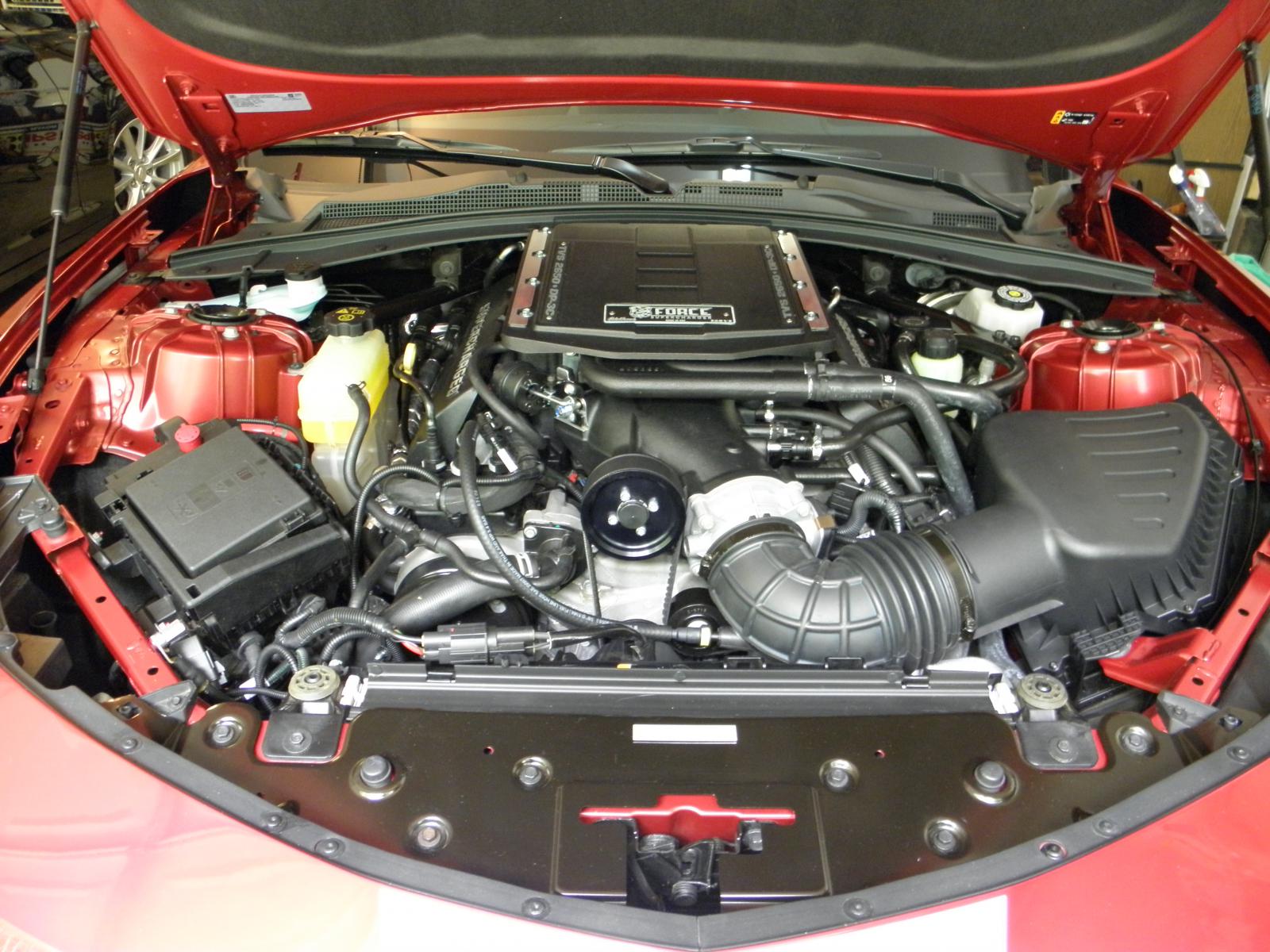

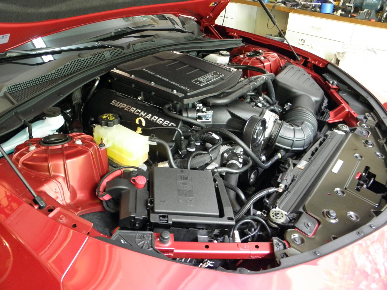

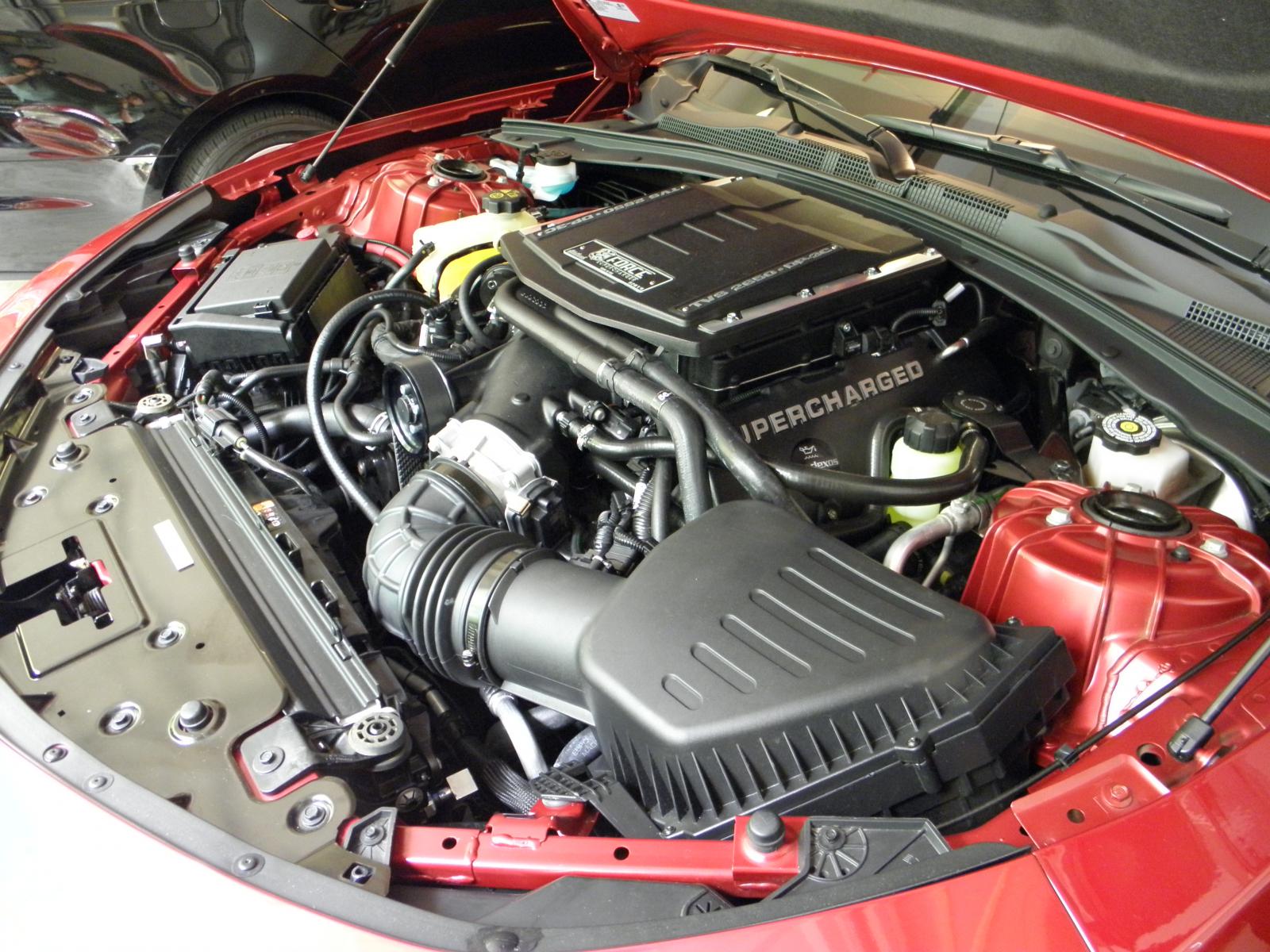

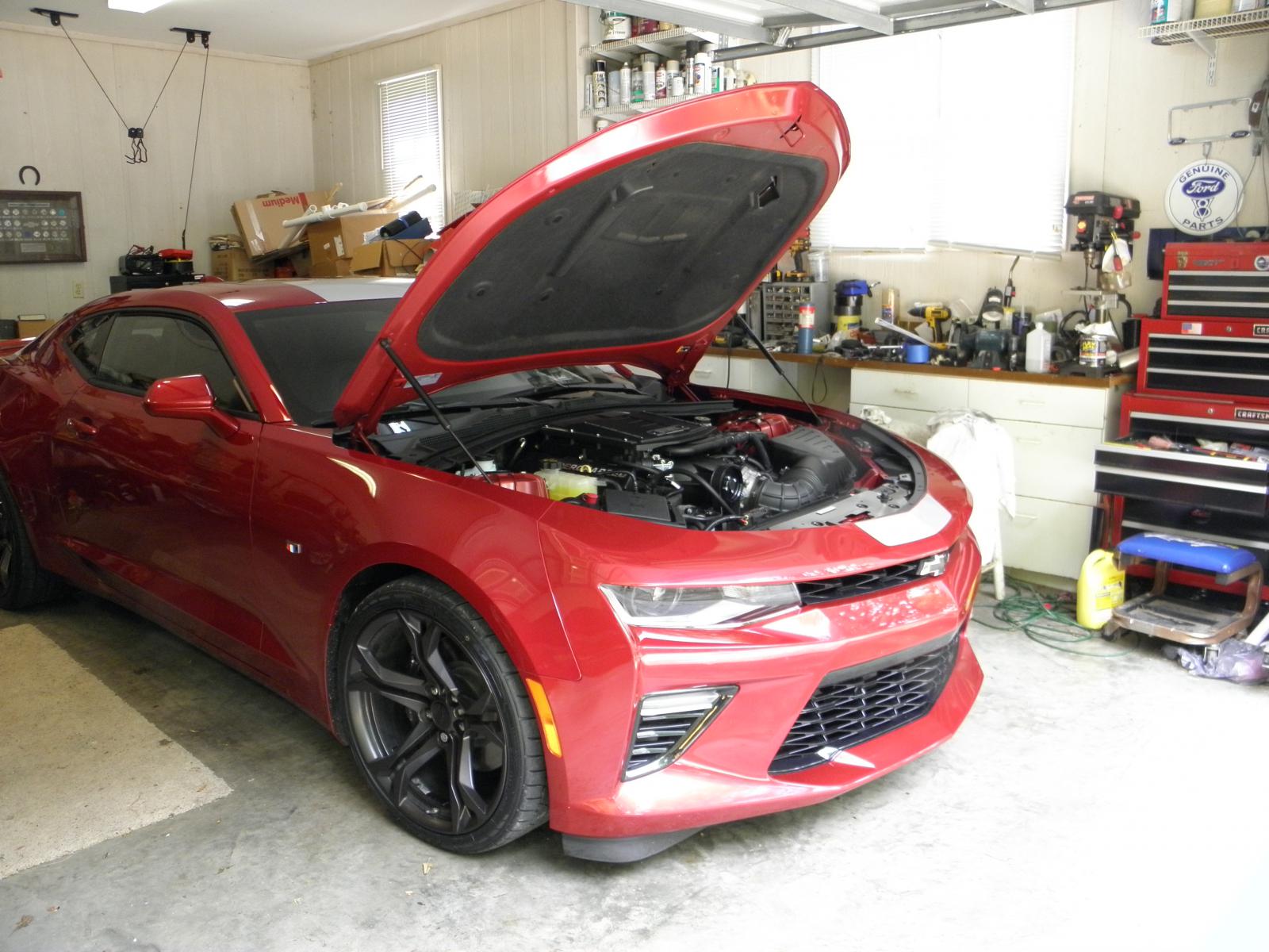

All Is Well With the eForce
We had a few self-inflicted glitches, but Edelbrock tech support came through admirably.
The car is complete all buttoned up and running like a champ. A pic:
The new ride: 2023 Camaro, LT1, Sharkskin Grey

Originally Posted by TheRealJA105 View Post
Did you pee in your coolant tank after drinking a Monster?
But seriously where's the Dexcool?
I had a feeling someone would notice that...lol. I spent an hour plus cleaning the engine and under hood and tried to make everything look factory knowing it would be scrutinized by some. I happened to have a bunch of 50/50 coolant and didn't want to run out to get some.
