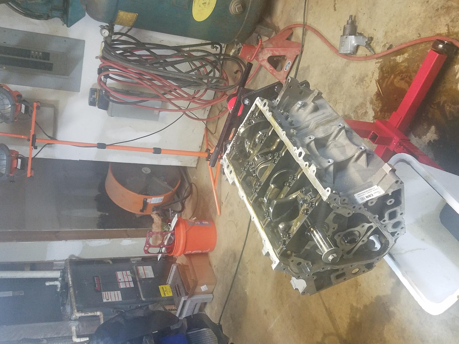

Day Three is in the books. Got the motor out and partially disassembled. Need to yank the pistons and crank and take it to the machine shop for balancing. Going to have the shop assemble the heads too. They can measure/ shim to ensure spring height and seat pressures are correct plus I don't have a spring squeeze that is compatible with these heads.
This is the first LT motor I've been inside of and I must say I am impressed. Hell for strong looking bottom end.

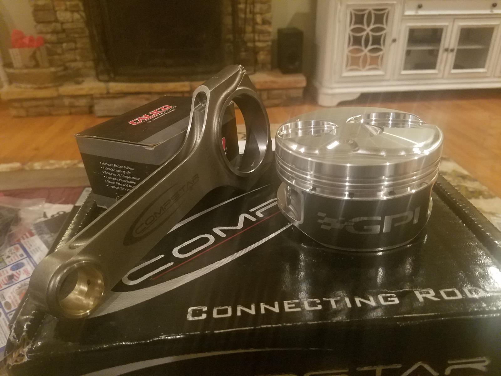

You have to admit that this is some good looking hardware. It's been sitting on the shelf for a couple of months, I finally got around to opening it up tonight.

Those compstars look just like my Manley rods.
Did you balance your rotating assembly? I've always balanced and figured it's cheap insurance. It will be interesting to see how much weight, if any, needs to be added or removed.

Yes we did, wouldn't put it together without it. What cam did you decide to go with? We got rid of dod and vvt.

I'm going with Ted Jannetty's smooth idle blower cam which is a Texas Speed blank ground to his specs. I'm locking the cam gear and installing dod plugs.

Thanks, Goose. It's been fun and enlightening so far. I've taken apart literally dozens of motors over the years, big and small blocks from all domestic manufacturers as well as numerous imports. This is my first post 1st gen Chevy smallblock and I must say that I am very impressed. Prior to this, I assumed the block architecture was much more similar to the original than is actually the case. I can now understand how these motors hold together at high three digit power levels and above.
This motor is definitely the state of the push rod V8 art.
