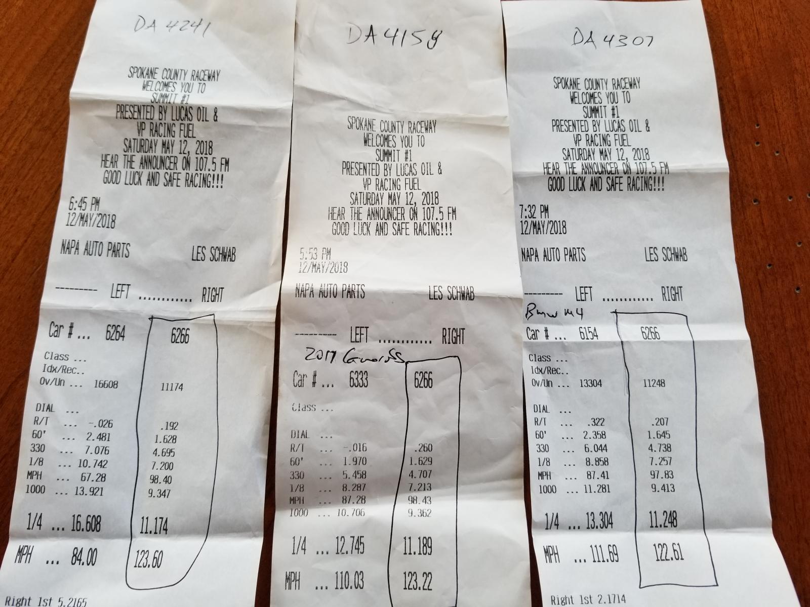

First Friday night drags of the year are this Friday 5/11/18. If the weather holds out I am planning on going to see what it will do with the Whipple, Whipple Canned Tune and drag radials.

Drag radials are on. Heading to the track for the first time with the Whipple tonight. DA is forecasted to be 3,400, not great but at least I will get a feel for the Whipple on the Track.

First day at the track with the Whipple Supercharger installed. Pretty impressed DA over 4,000 consistently in the low 11s. Whipple, canned Whipple tune & Drag Radials everything else stock. Should be in the 10s if I can get some decent air.
