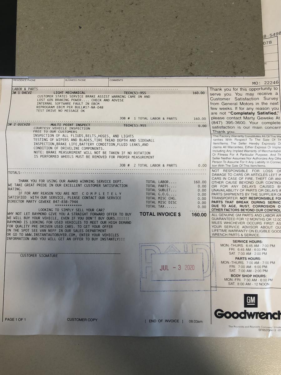

I just experienced this issue and thanks to checking in the forums here had it taken care of with a service bulletin. I understand this is an old forum, but with low mileage cars still out there, this issue is still very real in 2020 and I wanted to help anyone I could.
My brake assist warning came on and I lost about half my braking pressure and it felt that ABS was on 100% of the time. This is mentioned in the owners manual as normal behavior when the service message occurs.
I turned the car on the next day and the issue was gone but took it for service anyway. They told me there was a service bulletin and they will simply run a diagnostic and if no issues are found other than the TSB then that's all they will charge. It happened 8 hours prior the night before the computer had all the error codes stored so they were able to pull them up without any active CEL or Error Codes.
Should be a recall and not a TSB but just needed to share this as these forums are the reason I knew of the fix ahead of time. Maybe a diagnostic fee is worth the piece of mind to get the update needed rather than waiting for the brakes to fail in traffic as mine did.
"Internal software fault in EBCM. Reprogram EBCM per BULL#17-NA-048"

You wont get the error unless it occurs, so diagnostic tests wont save you from experiencing the loss of ability to stop while your abs thinks you your wheels are locked up.
This should be an abs recall ...especially if the source of the issue is a software error so it isn't anything but a reprogram needed to fix a potontially costly safety problem.
GM never learns.
