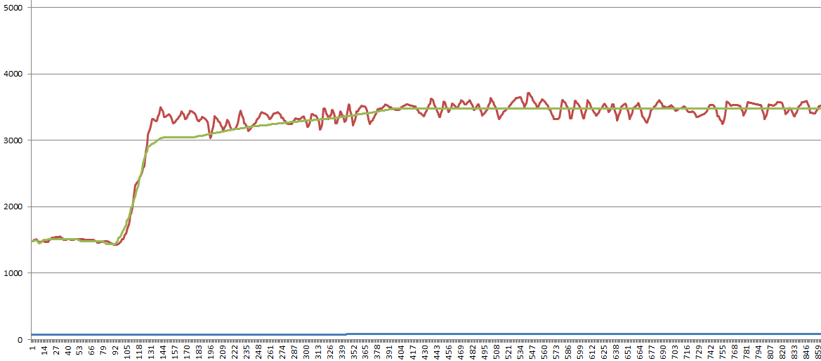

High side fuel pressure discussion for anyone doing their own tuning...
Something that was in my tune before I took it over it was ~3400 psi high side peak. The car has been like this for 5 years and makes great power and reaches commanded high side fuel pressure...See attachment from a dyno run back in 2021.
I'm stock ZL1 LT4 high side fuel pump, stock low side pump w/JMS FuelMax, and stock injectors. I have a cam w/larger fuel lobe, tvs 2300, and everything else you'd expect to reach 800+whp
The car has no issues. I understand the concern for injectors to misbehave above 2900 but this was a setting I never looked at touched once I took over the tune a few year ago (there wasn't issues in this area so just missed it). Peak injector DC is 5 ms, it was below 5.4 ms before I added a 50/50 meth spray. I assume if I turned down pressure that I'd need more DC to compensate... anyone experiment with this?
I guess my takeaway is it is possible to maintain those pressures with stock everything fuel system wise (w/JMS). This also might be something to "turn down" a little and see how the car responds.

While your post is off topic, I have experience with cranking up the pressure on the stock LT4 stuff. 3400 is about the max where the stock injectors are happy. You need a cam of course to maintain that pressure. I have a few of those setups running pretty big meth kits. I just dyno tuned a couple of ZL1's like this. One was on stock blower and stock pulley that hit 798rwhp and the other one was on a smaller cam but max effort blower and pulleys and more meth and it made just shy of 900rwhp.
Both cars with stock LT4 fuel system parts, 32% fuel lobe and meth.
