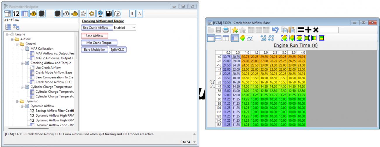

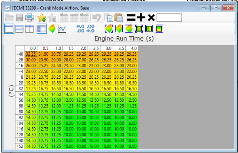

Thank you both, much appreciated. When you say "Startup Airflow" I assume that you are referring to the "Cranking Base Airflow", found in Engine -> Airflow -> General -> Cranking Airflow and Torque -> Base Airflow? If yes, then today I had the opportunity to work on my stock file and made the following changes, as suggested by RobZL1:
The first screenshot shows the Stock Crank Base Airflow table and the second one shows the modified "Low Bark" Crank Base Airflow table.
If this what you are suggesting, then I can write the new file containing the modified "Low Bark" Crank Base Airflow table to my car and see how it sounds. Maybe I can even copy the values of the 4th column (1.5s) to the first three (0s, 0.5s, and 1s). Should I be aware of any issues?

I wouldn't do it that way. I would copy the stock values from 0.5 column to the 0.0 column and then interpolate between column 0.0 and 1.0.
Your screenshots will likely cause a stumbling rough sort of startup, especially when warm. You need to just reduce the bark, not eliminate it.
All of that said, test it and find out. Don't be scared.

Thanks. This is what I prepared. I will write it to the car some time this week and will let you know.
