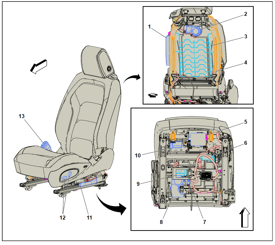

For your last question: below is a diagram for the driver seat. I assume you are referencing the #5 part? This is the K40D - seat memory control module. This module has 5 connectors (X1, X2, X3, X5, and X6). So it sounds like there is presumably an X4 connector that is not there by design.

Hi cam765
Yes, it is the #5 but not sure what is the number of connector which is missing (if it is X4) I can only mark it in the picture (like I did above).
So you are saying it is ok that there is no plug there, right?

Yes, I would guess that there should not be a plug there. The service manual doesn't show a whole lot, other than the description of each of the 5 connectors. But I am not sure which one corresponds to the actual module.
X1 - 2 way connector, L-GY* (2 occupied)
X2 - 6 way connector, BLACK (3 occupied)
X3 - 12 way connector, L-GY* (8 occupied)
X4 - does not exist
X5 - 26 way connector, BLACK (13 occupied)
X6 - 20 way connector, GRAY (3 occupied)
*L-GY means light gray possibly?
Anyways, looking more closely at this module in the driver's seat, it is responsible for primarily the motors in the seat, etc. It has nothing to do with seat heating and cooling.
