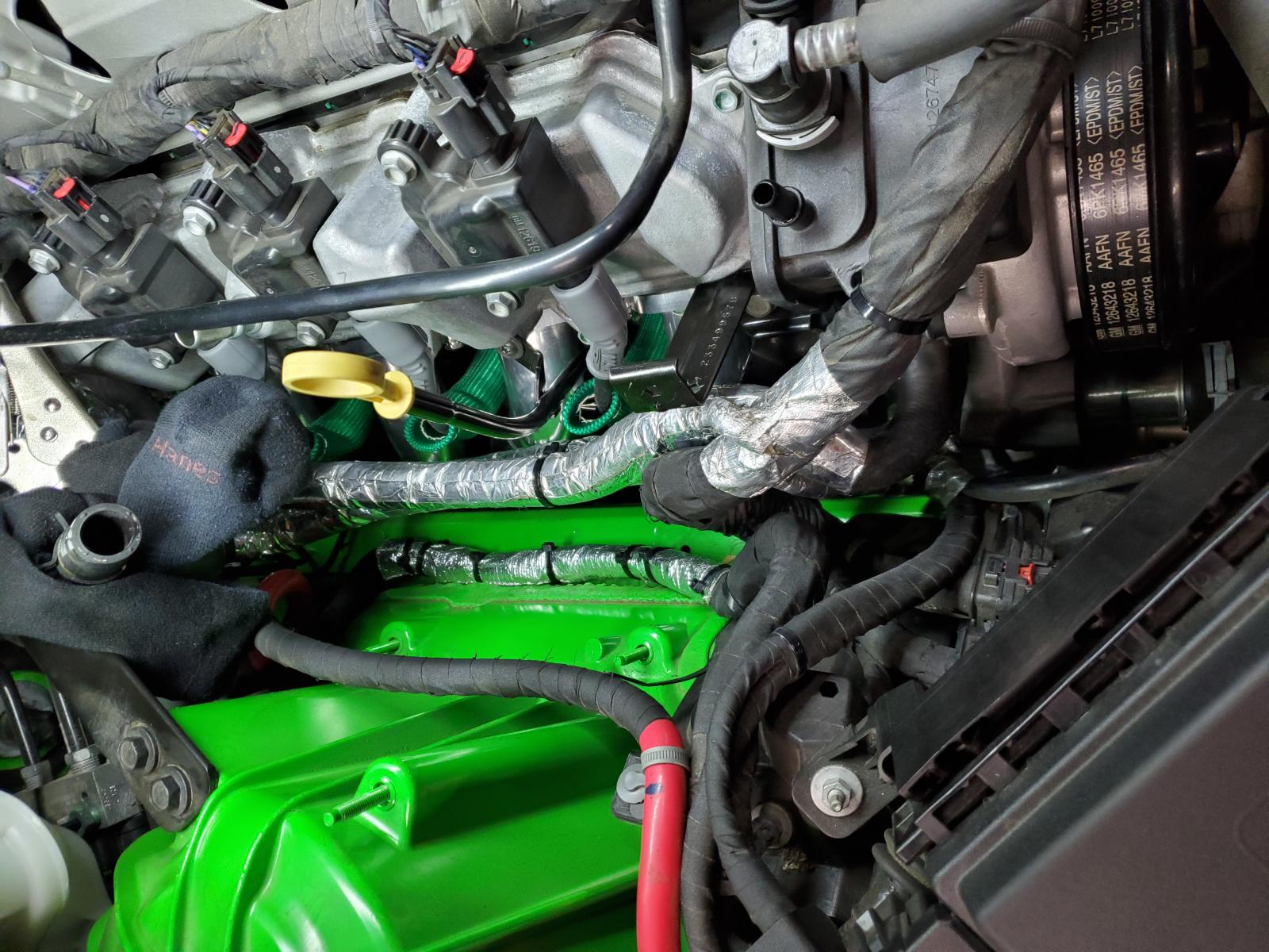

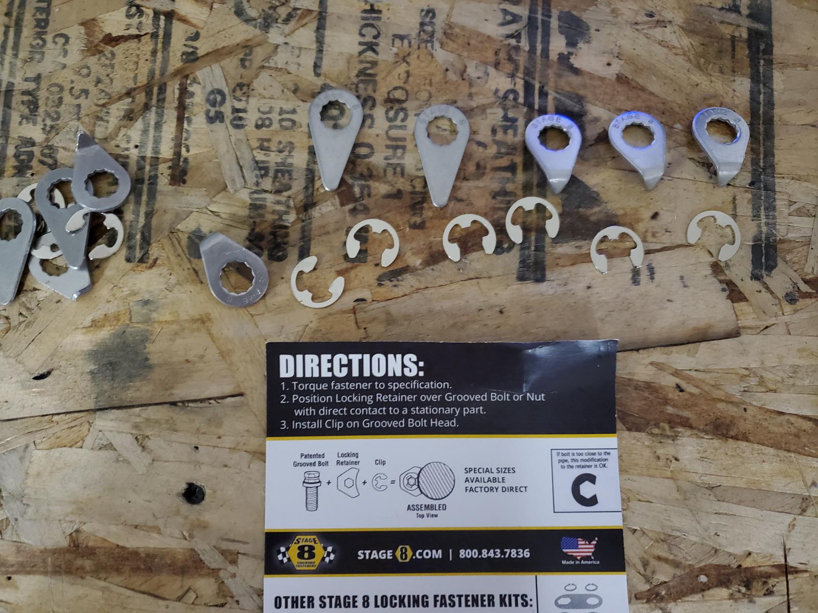

Got it all put together and realised I forgot the header bolt clips, fml. So I gotta tear it back down a little get access to a few of them. I do need to put them on correct? The wiring harness under the overflow tank didnt have to move much tbh. I think that's what they give you the heat shield tape for lol, sounded good at least. So I put it on and zip ties it for good measure. Started it up, no leaks as of yet, at least under the car, didnt check the top but tried listening for it. I'm not going to drive it tomorrow untill after work because I think I might need to out these header clips in

Omg yes, they all make it look so easy. Biggest thing I can say is dont rush, my car is my dd for work, so that adds alot of stress. A pivoting stubby ratchet and a ratchet wrench are lifesavers! Definitely can do it on the ground, and definitely recommend 6 tons jack stands for that extra height. $50 a pair at harbor freight, unless you have some that go higher than 17" like I had, lol. I just took it out, steering is all good, I dont think I have leaks, it's weird, it sounds like the sound ppffff when I accelerate, but when I get off it goes away, even on decel. When I get under the car, under idle, I feel no leaks. Is it possible the headers increased the sound of my rotofab? I would think if it was a leak, I would hear it on decel. I haven't gotten on it, and probably wont untill I get a tune but so far no check engine light, strange, I'm sure it will come on eventually. Maybe because I'm babying it.
