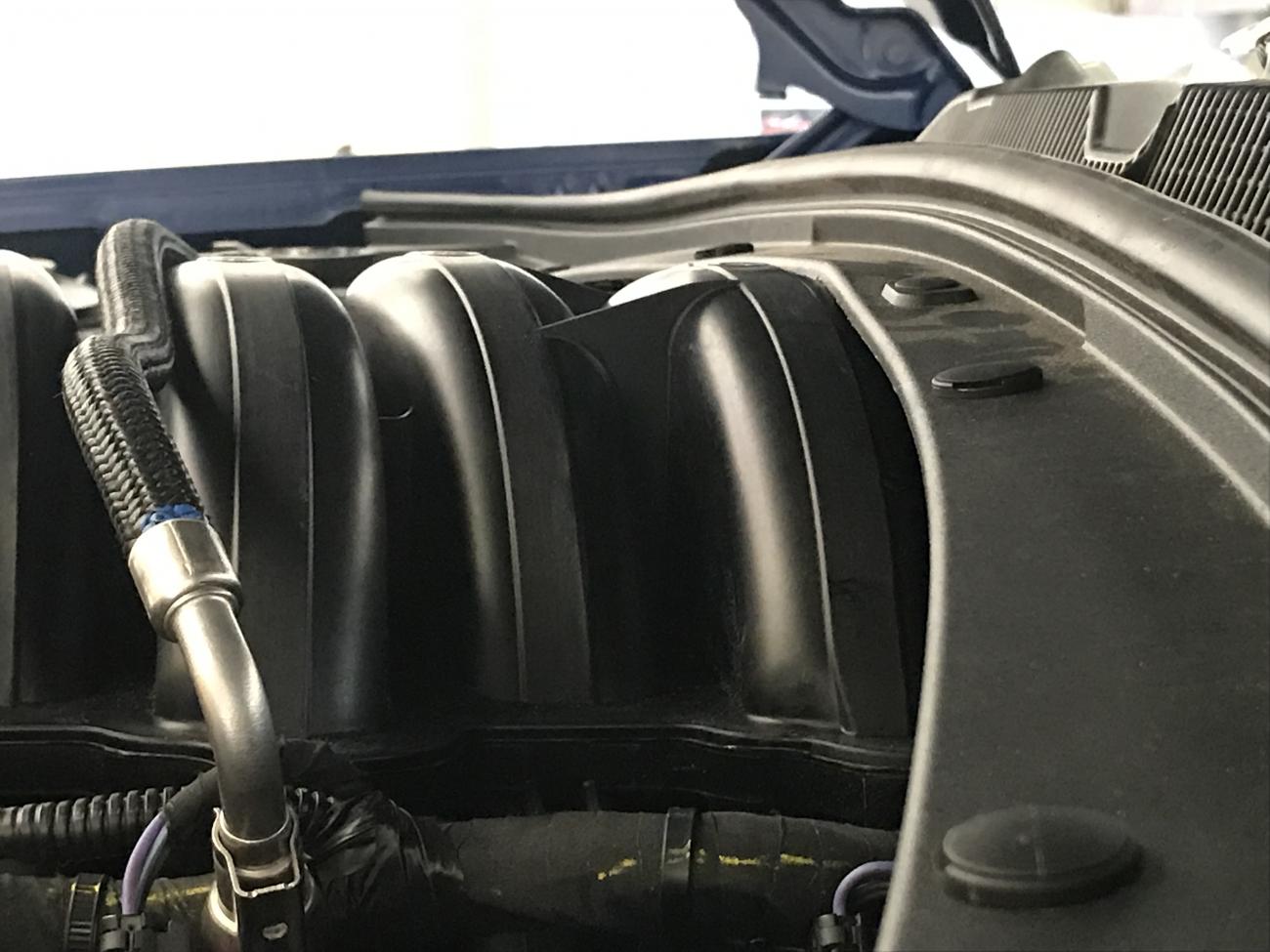

I plan on seeing if the intake will fit on the camaro. If it’s 1 inch shorter than the truck intake it will fit. I bought a l86 intake to see if you could make a truck intake for and it was surprisingly close.
If you could just lower the cradle a tad that would just slide on
I think if you use the aftermarket motor mounts you just might have clearance.. I believe they drop the motor about 1 inch... not 100% sure
Yea it literally just needs to be a inch lower to slide the rest of the way back.
We will see whenever the lt2 intake is available to purchase I’ll go ahead and order it and see what all it takes to make it work or not work. Should be a nice upgrade though.

Is it possible that the LT2 intake simply be able to be turned 180-degrees and bolted on?
Is it possible it is that simple?
Or is there possibly some component in the valley area that is in the way? The cylinder head port offsets don't line up right?
I've not had the intake off my LT1, but I know many V-engines you can rotate the intake 180 and it will bolt on...

Does anyone know if you can loosen the cradle bolts to get a 1/2 inch to sneak that truck intake on. I think once it’s on the engine it will fit without issues
