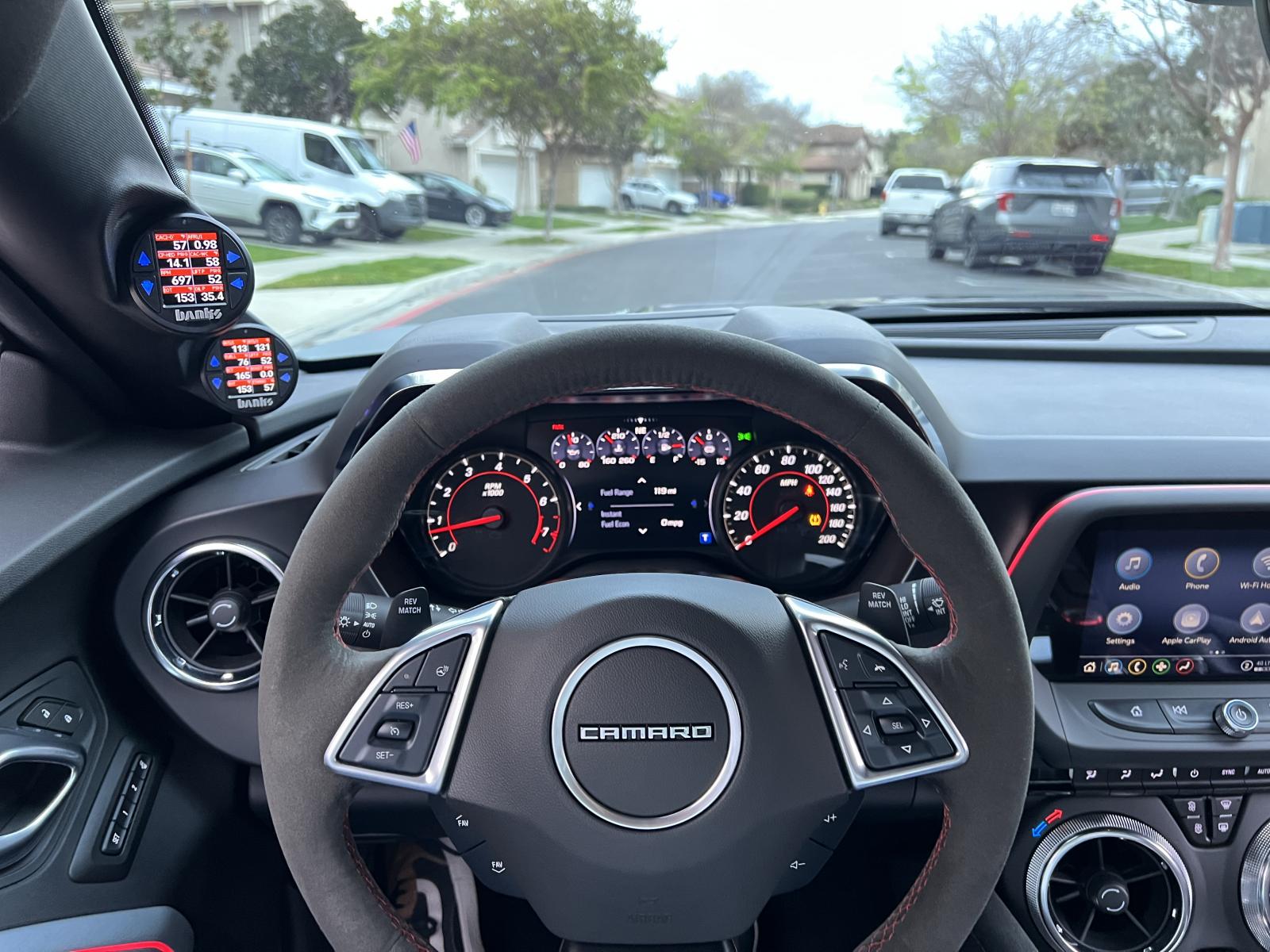

I’m running the same setup but having a hard time with the gauges staying in place. Any tricks you had to do for that?

What gauges are you running? And are they the right size? I too had issues with my datamonster iDashes turning. I wouldn't really consider it an issue, I just added a few rounds of electrical tape to the gauges rear and pushed it back into the pod, no issues anymore.

I agree... the ZZP is the best looking / functioning dual pillar on the market... which is why we put that in our AEM / Banks gauge bundle.... ZZP for the WIN on this one for sure!
